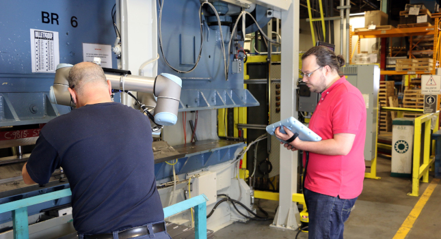

Depending on the application and industry, there are very different expectations. This is also true for compliance in a safety context, especially when it comes to human-robot-collaboration without guards (“cage-free”). Keep in mind that there are excellent collaborative application using safety laser scanners and these applications are also “cage-free” (no perimeter guard). The fundamental point is that the robots permitted to contact a person are those with power and force limiting (PFL) capabilities.
Courtesy of: Universal Robots

Robot arms are often mountable in many different ways, such as to a wall, upside-down or on top of a table or mobile platform,and can be equipped with various end-effectors. Robot integrators face further challenges: Will the robot system be compliant for collaborative and cage-free use after the addition of end-effector and parts?
First, some questions need to be answered. The parameters needed  payload, reach, performance, etc. — have to be clarified for the robot and the additions that be used in a robotic system. From a compliance point of view, many different additional factors exist when a cage-free collaborative application is desired. These need to be taken into account.
We tackle this challenge in two ways: First, we only guarantee compliance of our “partial machine  that is, the robot (arm or manipulator, controller and teach pendant to enable its use in collaborative applications. It is a power and force limited robot where the capabilities are provided by safety functions.  Second, it should be emphasized to distributors and end customers that a risk assessment is required to make the robot application (robot system + additional parts and equipment) compliant, e.g. to safety standards including the technical specification ISO/TS 15066.
