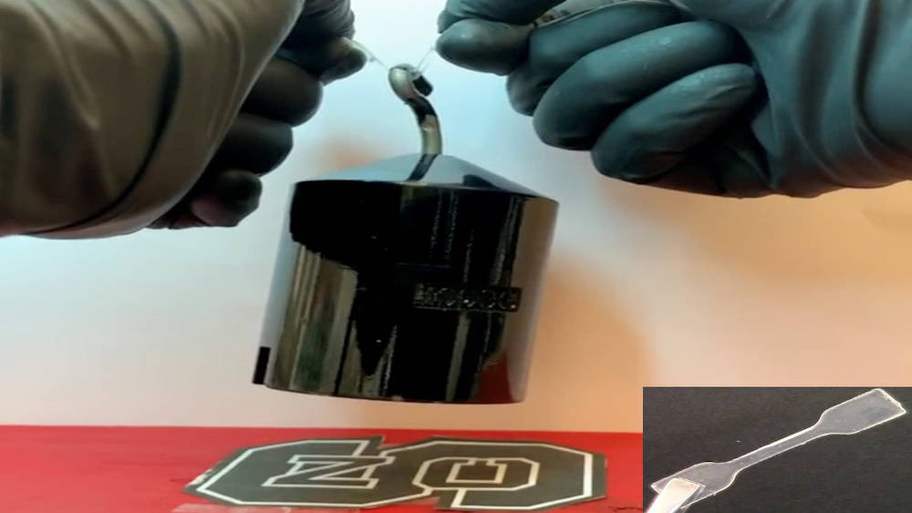

North Carolina State University researchers have created ionogel materials that are stretchable, tough and can be 3D-printed. Courtesy: North Carolina State University
