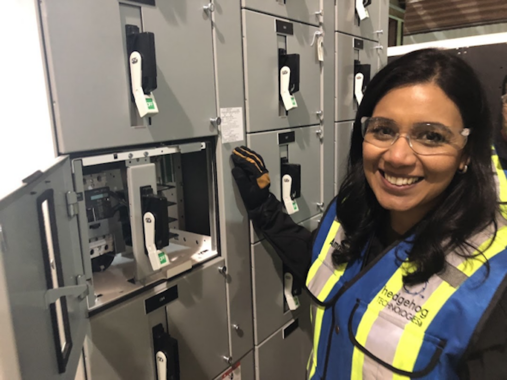

Electrical engineer doing final inspection on a motor control center for variable frequency drive bank. Courtesy: Hedgehog Technologies
