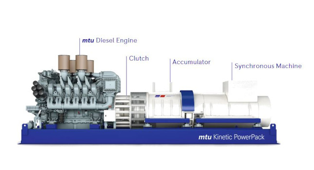

If the diesel engine runs at 1800 RPM, and the synchronous machine runs at 3000 RPM, is there a transmission to step up the speed?
Yves Jansen: For 60 Hz application, the nominal speed of the Diesel engine is 1800 RPM, the synchronous machine runs at 1800 RPM and the Accu at 3000 RPM.
More details about the architecture of the mtu Kinetic PowerPack can be downloaded from the following link:
https://kinolt-my.sharepoint.com/:b:/p/yves_jansen/EaKVBBYJb9xCpdPGf2mgMrYBTMWjO_gHNv5L7HUXesFzrQ?e=A9BRN2
