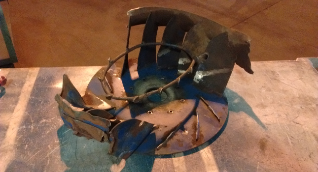

Visual inspection. Let’s say the unit has failed bearings, a damaged shaft and drive belts that are no longer on the sheaves. You see the back plate of the impeller with most of its blades ripped off and lying on the bottom of the fan housing. The inlet cone is badly dented and ripped half-way around its circumference (see Figure 1).
Figure 1: Badly damaged fan impeller. Courtesy: Holming Fan & Fabrication LLC
Action plan. Mobilize your maintenance mechanics and electricians. Start the disassembly process. Record the bearing, belt and sheave numbers for purchasing to start the procurement process. If no identifying tags are on the fan and if the lead-time to specify, procure and install a replacement impeller from the original equipment manufacturer (OEM) is prohibitive, search the internet for someone with the experience to repair or fabricate a replacement hub, impeller, inlet cone and shaft immediately.
Once you find a qualified impeller fabricator who understands the meaning of “we’re down,” collect all remaining pieces of the fan wheel, hub assembly, inlet cone and shaft and send them by dedicated truck to the fabricator.
Keep in constant contact with the fabricator for progress updates that can be relayed to personnel in-house. It’s vital to know timing and how the fabricator goes about doing its job. If necessary, visit the fabricator as often as necessary and be sure to ask if the impeller will be dynamically balanced before leaving the shop.
