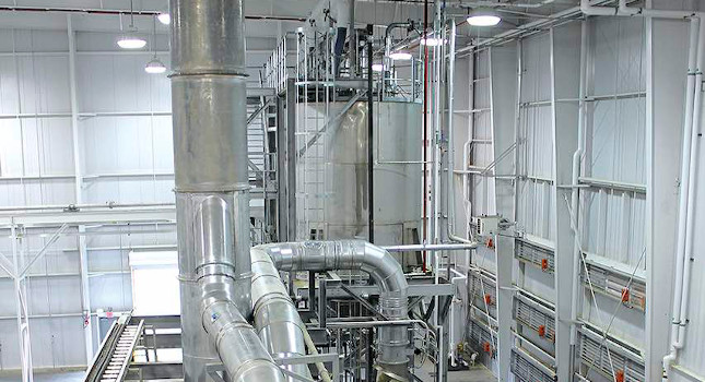

Sandridge: A recent project for SWARCO in Mexia, Texas, gives a great example of building system and process system integration. Exhaust fans and cooling systems were actually attached to the superstructure of a large piece of process equipment. Both structural and electrical modifications were required for the process equipment. This design resulted in less ductwork and piping to be installed, had
