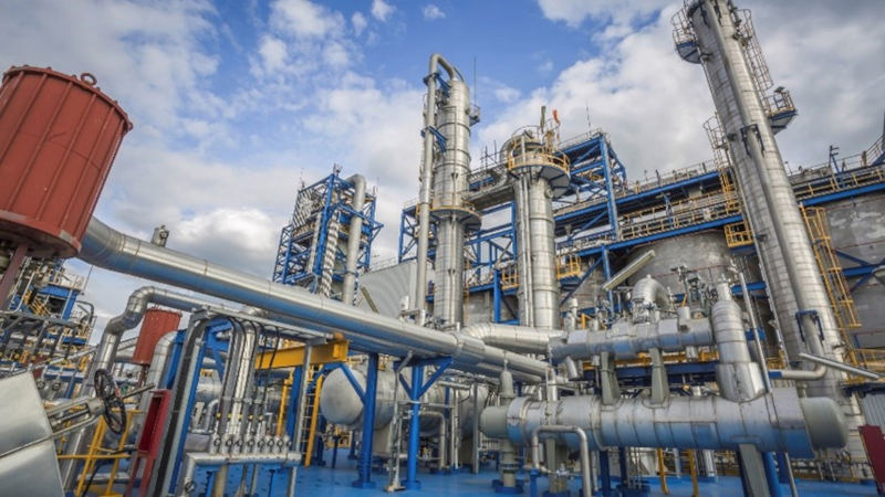

In the refining industry, catalytic hydroprocess­ing elements, such as hydrotreater, hydrode­sulfurization and hydrocracker units, rely on high-performance catalyst technologies to maximize product conversion (see Figure 1). Simultaneously, efficient reaction control seeks to minimize the environmental footprint and cost. Precise and reliable temperature mapping of these densely packed reactor catalyst beds is required for stable and profitable unit operations. Multipoint temperature instruments with thermocouple sensors are widely used in the industry to monitor for optimum heat distribution, and to prevent hotspots and premature catalyst deactiva­tion under high temperature, high pressure and corrosive conditions.
Figure 1: Refineries need reliable temperature measurements to optimize operations. Courtesy: Endress+Hauser

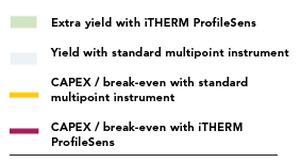

Measured against an average daily unit profitabil­ity and a continuous operation of 36 to 48 months, the resulting extra revenue generated fully offsets the capital expenditure (CapEx) (see Figure 3).
Figure 3: CapEx is the instrument and installation cost. Example of typical cost delta, actual cost may vary depending on product specification, configuration and services. Courtesy: Endress+Hauser
Figure 3 legend
Figure 3 legend. Courtesy: Endress+Hauser
With iTHERM ProfileSens, the initial CapEx (left y axis, base 100: standard multipoint installation), while minimally higher, is quickly offset through higher yield (right y axis, base 100: standard mul­tipoint installation) and savings. The major factors leading to this quick return on investment are:
  • Higher unit performance and conversion
  • Higher efficiency
  • Faster installation and turnaround
  • Lower operational expenditure (OPEX).
As the number of measurement points increase, the savings effect grows to the point where the initial investment becomes negligible when compared to the increased returns. The new technology’s robust­ness, reliability and longer operating life makes it a compelling choice for harsh process conditions.
