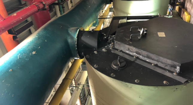

The two existing firetube boilers at the BASF facility in Durham, N.C. were manufactured by York Shipley Inc. in 1981 with a capacity of 300 boiler horsepower each. The boilers operated admirably during their 40 years of service (see Figure 1). However, with age, the boilers started to require increasing maintenance. With renovations and improvements downstream came a large reduction in steam output needs. The boilers, being limited on steam output turndown, began short cycling in the summer and winter. The on/off operation resulted in more stress on the boiler and burner equipment and a reduction in overall energy efficiency of the system.
Figure 1: BASF’s original York Shipley boilers. Courtesy: Inveno Engineering, LLC
The existing spray deaerator was not meeting ASME dissolved-oxygen requirements of 7 ppb. This resulted in an increase in non-condensable gases to the boiler and eventually into the steam system. With these elevated non-condensable gases in the system, higher corrosion rates of internal piping and infrastructure did occur. All other associated equipment such as blowdown tank, chemical feed system, makeup water meters and steam flow meters were deemed to be older technologies and needed to be updated to the latest technologies.

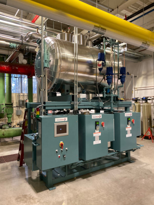

Deaerator (spray versus tray design)
The new deaerator design was required to provide a feedwater dissolved oxygen content of no greater than seven ppb and operate at steam pressure of 8 psig with a 20-minute feedwater storage time for the boiler operation (see Figure 5). Reviewing the two deaerator design choices, the spray type and tray type design, both deaerator types can provide the performance standard dictated by the engineering RFPs. However, due to height considerations of the existing boiler plant, it was decided to proceed with a spray-type deaerator that had a lower height requirement and maintained the required net positive suction head (NPSH) for the boiler feed pumps. The control system for the deaerator was another area where the plant needed to have control of the steam pressure, feed pumps and monitor the critical points in the system.
Figure 5: New deaerator at the BASF boiler plant. Courtesy: Inveno Engineering, LLC

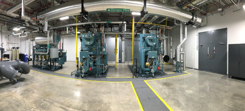

The philosophy of BASF and the Inveno steam team demanded the boiler plant be free of components not related to the boiler operation. The boiler plant is not a storage area; it is an area where the combustion process is occurring with a very combustible fuel. The other factors are to have a clean, well-organized and well-lit environment for the boiler plant personnel that provides an excellent work environment and work habits (see Figure 6). With this type of environment, the boiler plant will stay in this condition for the life of the boiler and plant personnel will take pride in their plant.
Figure 6: It was important to BASF to have a clean, well-organized and well-lit environment for the boiler plant personnel that provides an excellent work environment and work habits. Courtesy: Inveno Engineering, LLC

Figure 7: The boiler room layout is improved for more efficient operation and maintenance. Courtesy: Inveno Engineering, LLC
