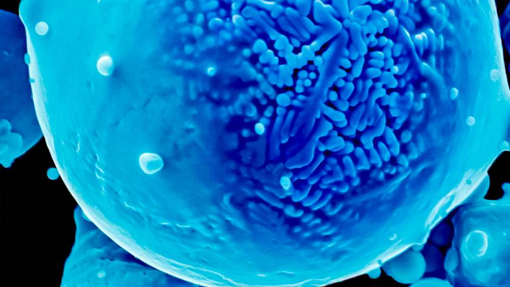

New method developed by Texas A&M researchers optimizes alloy properties and process parameters to create superior 3D-printed metal parts. Shown here is a colorized electron micrograph of a nickel powder alloy used in the study. Courtesy: Raiyan Seede, Texas A&M University
