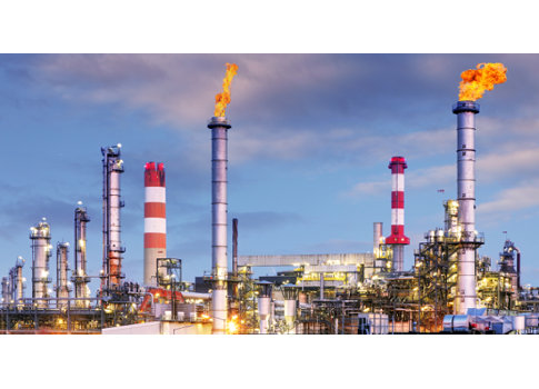

Flares are a common site in petrochemical plants. They are used to safely incinerate products that need to be disposed. Ideally the load on a flare should be very light. However, there are times where there is a large amount of product that cannot be stored and incineration is the most practical solution. High loads on flares will normally occur during an upset condition such as a safety valve opening or a unit being out of service that would normally process the product being sent to the flare.
When incinerating these products, combustion efficiency is of paramount importance, as well as the avoidance of "smoking" or releasing carbon that can be seen. To accomplish both of these goals, flares often use steam or air for the flaring process.
