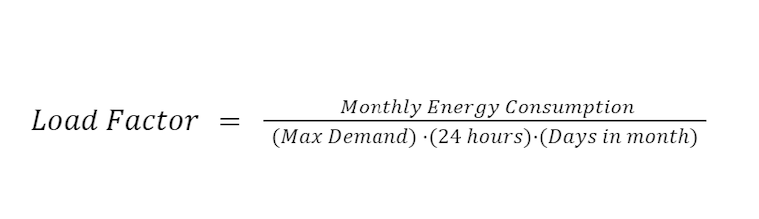

The load factor (not to be confused with power factor) is calculated by dividing monthly energy consumption by peak demand and 24 hours and the number of days in that month [Figure 1]. A load factor above 80 percent is considered excellent whereas a demand factor below 50 percent is not desirable.
 Figure 1: Load factor equation. Courtesy: Hedgehog Technologies
