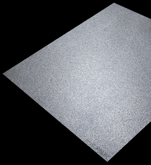

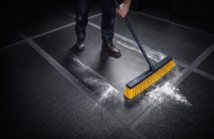

One emerging response to that compromise is a class of sweepable, high-traction stainless steel surfaces engineered specifically for dry processing facilities. Rather than cutting deep grooves, these surfaces fill the microscopic valleys of a high-friction texture while leaving millions of tool-steel-hard traction peaks exposed, so a standard push broom can clear the surface in a single pass without sacrificing grip.

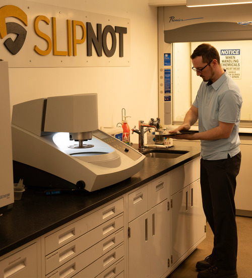

That gap reflects a metric problem as much as a material one. Plant managers evaluating flooring should look at Dynamic Coefficient of Friction (DCOF) rather than older static tests, since DCOF measures grip while someone is actively walking. This gives a more realistic picture of how slips actually occur rather than a test with someone standing still. For a dry processing zone, the number that matters most is dry DCOF measured with fine powder worked into the surface, not a clean, dust-free reading alone. Under American National Standards Institute (ANSI) A326.3 protocols, a dry DCOF above 0.80 on a clean surface indicates excellent baseline traction, while a reading above 0.60 with contamination present is considered reliable in real-world use. In-house testing of one such engineered surface recorded a clean dry DCOF of 0.97 and 0.71 with flour worked into the surface, comfortably clearing both benchmarks. Any flooring specification should require documented DCOF data under contaminated conditions, not just a clean-sample rating.

Surface sweepability deserves the same verification as traction and compliance. Comparative lab testing of five common industrial floor surfaces — using UV tracer powder to visualize particle retention before and after sweeping, alongside dry DCOF measurement — found that dotted metal and diamond-pattern surfaces marketed as “easy to clean” still retained significant debris after repeated passes, while the sweepable engineered surface came clean in far fewer passes. Plant leaders evaluating any flooring option should ask suppliers for before-and-after cleanability data rather than relying on unverified claims.
