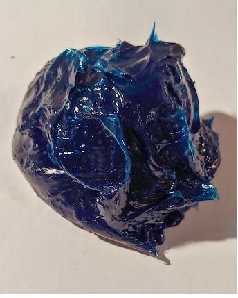

Rheology: Grease stays put until there is sufficient stress (yield stress) by mechanical force, heat, centrifugal force, etc. at which point, grease flows.
Example of grease.

The rheological behavior of grease is a function of many variables, including but not limited to thickener type and content, base oil type and viscosity, manufacturing processing differences, etc. The addition of structure modifiers (polymers) will further impact the rheology.

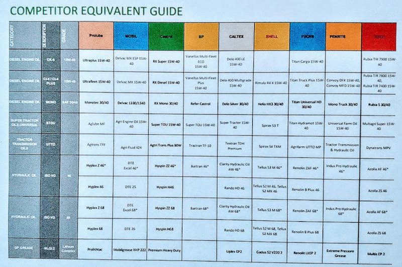

The proliferation of standard specifications for lubricating oils has led to development and publication of many “cross reference” charts:
Competitor equivalent guide.

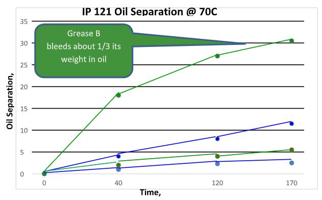

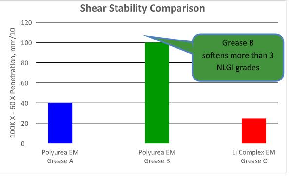

Read-across for greases is dangerous. Simply specifying the NLGI grade and EP additization does not guarantee these greases are in any way equivalent to one another. If their base oils are not the same type or viscosity, they are not equivalent. If they have different performance properties (anti rust, load carrying, water resistance, etc.), they are not equivalent. Even if these greases all had identical formulations, they would probably perform differently due to how each was manufactured.
For example, two electric motor greases appear very similar according to product data sheet claims, but perform very differently in mechanical stability and oil bleed tests:
Shear stability comparison.

Oil separation chart.
