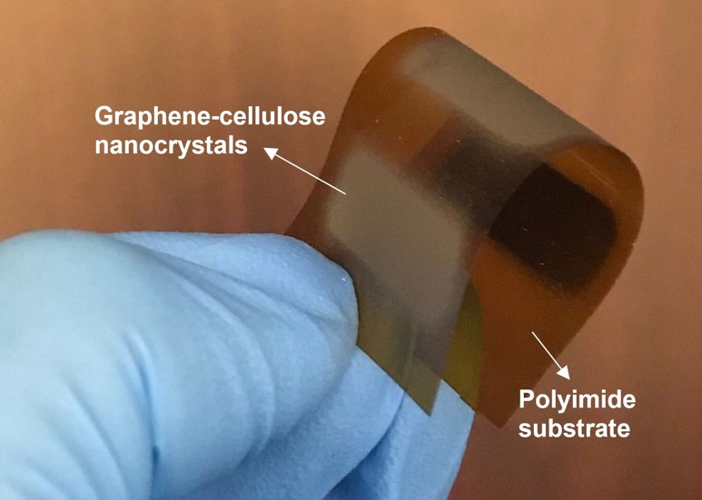

Jarrahbashi said that the team has established a new in-house, spray-deposition manufacturing technique. It uses supercritical carbon dioxide (CO2) to assist with atomization and create very fine and uniform micron-size droplets containing nanoparticles. By engineering the self-assembly of multiple materials inside the deposited droplets, they can fabricate multifunctional, nanostructured components — all without the need for costly preparations or the use of hazardous solvents.
The team has established a new in-house, spray-deposition manufacturing technique that uses supercritical carbon dioxide to assist the atomization and create very fine and uniform micron-size droplets containing nanoparticles.
The team has established a new in-house, spray-deposition manufacturing technique that uses supercritical carbon dioxide to assist the atomization and create very fine and uniform micron-size droplets containing nanoparticles. Courtesy: Dr. Dorrin Jarrahbashi, Texas A&M University
