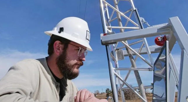

But Coburn is heading for something else: a metal tower, about 50-feet-tall with what looks like a security camera on top.
“We pipe the laser light up from there,” said Coburn, pointing at a cabinet at the base of the tower. “Then we shoot it at different targets around the site.”
As he talks, the cabinet beeps, and the laser emitter at its end begins to turn, sweeping over the landscape.
The tower is part of an ambitious undertaking from scientists at LongPath and CU Boulder. They’re using new laser technology to do what other technologies have struggled to do for years: detect natural gas, which is invisible to the eye, leaking from pipes at sites like this, in real time.

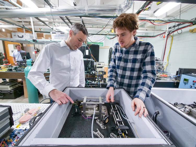

Greg Rieker (left) works with a colleague in the lab at CU Boulder. Courtesy: Colorado University.

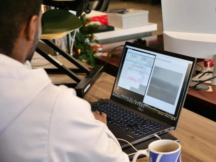

At LongPath’s offices in Boulder, Coburn and his colleagues open a computer window showing the data coming in from the system in Greeley. The graph shows a squiggly readout with sharp spikes like the teeth in a comb.
Each tooth corresponds to a color in the team’s frequency comb laser (hence, the name). Rieker explained that if you shine one of these devices into a cloud of gas, the molecules inside will absorb some of those colors but not all of them. In other words, molecules will leave an imprint on the laser light, almost like pressing your thumb to a glass.
“Each of these different molecules absorbs a different pattern of light,” Rieker said. “Methane has one pattern. Water and carbon dioxide have another.”
Comb-like spikes on a computer screen illustrate measurements of methane, water and carbon dioxide. Courtesy: Colorado University.

Or that was the theory in the mid-2000s. Rieker and scientists from NIST took roughly a decade to make it reality. First the team had to shrink these lasers, which could fill entire rooms, down to the size of a suitcase—then design them to survive the extremes of Colorado winters.
“We tested what happened when our laser froze,” Rieker said. “We broke it every way we could think of breaking it.”
