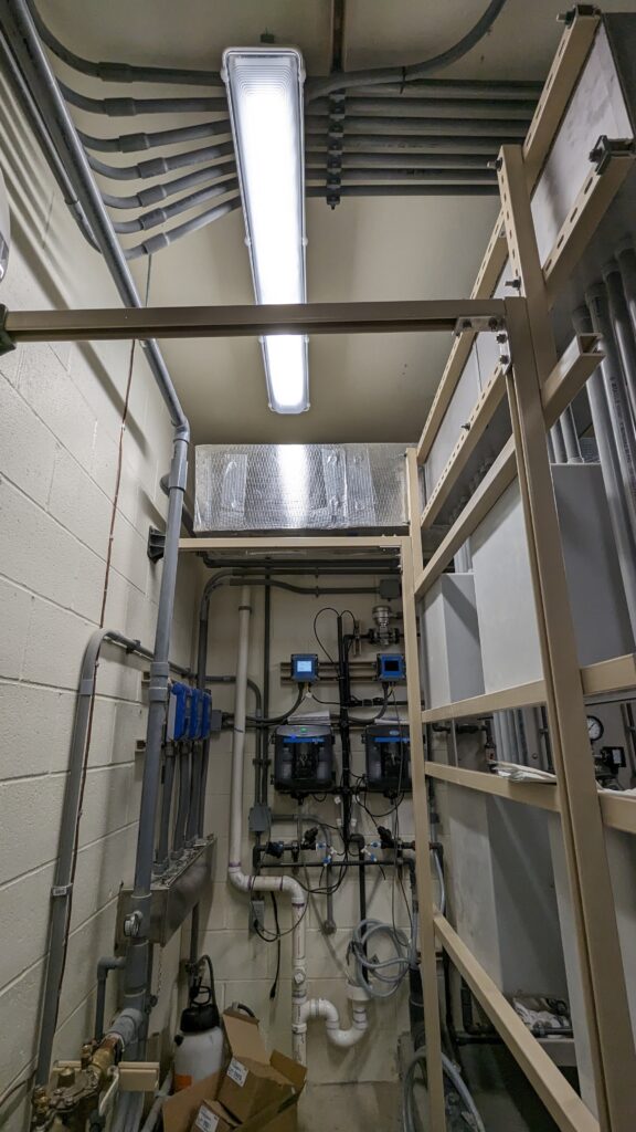

Figure 4: Chemical-resistant gasketed luminaire in a sodium hypochlorite building. Courtesy: CDM Smith
When taking this approach, the space and the equipment therein, including lighting, must be suited for washdown. Typical environments where washdown-rated fixtures are found include spaces in the food and beverage and chemical processing industries and some cleanroom environments.

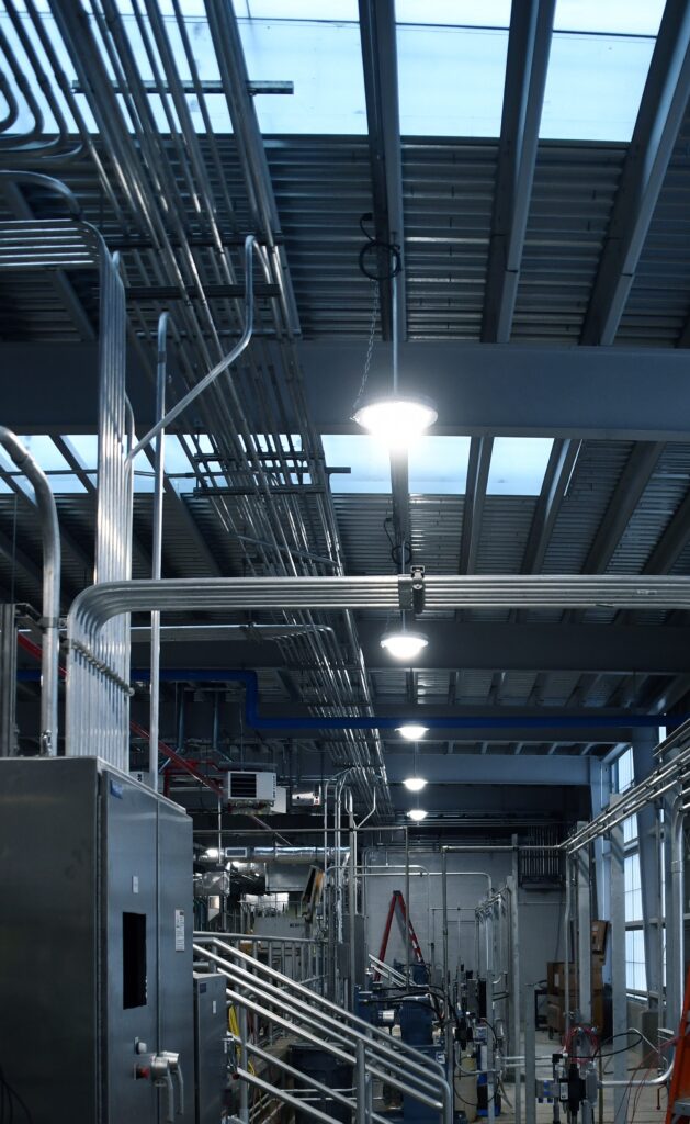

Figure 5: High ambient operating temperature high-bay luminaires at a wastewater treatment plant. Courtesy: CDM Smith
Other common aspects of light fixture selection include impact and vibration protection and temperature ratings. The IEC 62262 impact rating (IK) rating system defines the degree of protection that a light fixture has against mechanical impact, with ratings ranging from IK00 (lowest) to IK11 (highest). Light fixtures at risk of damage or vandalism should be selected to have a high IK rating. ANSI C136.31: Standards for Roadway and Area Lighting Equipment tests fixtures for vibration resistance at levels of 1.5 times the force of gravity (G), at 3G or up to 5G. Light fixtures can be tested by a third party and certified to meet the ANSI requirements.
Finally, the operating temperature rating of a light fixture must suit the application. A standard indoor light fixture has an operating temperature rating of approximately 32°F to 104°F. Environments with temperature extremes, such as high bays, hot areas of manufacturing plants or other unconditioned industrial areas and cold storage and cold climate areas often have ambient temperatures that are not within a standard light fixture’s operating temperature. These areas should have light fixtures selected with appropriate ambient operating temperatures for the environment in which they will be installed.
