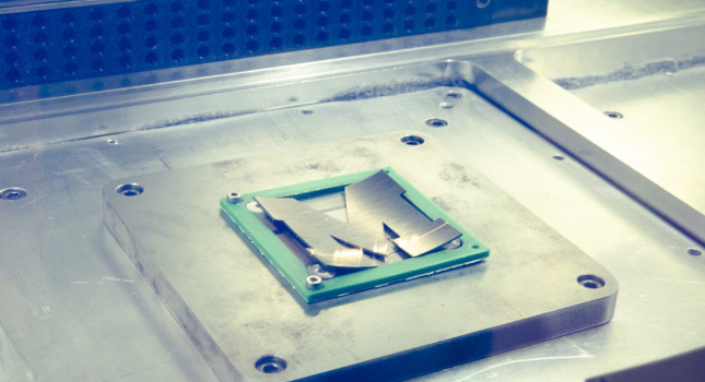

A steel plate in the shape of a Block M is marked with a laser inside the LPBF Panda 11 printer. Photo: Evan Dougherty/Michigan Engineering. Courtesy: University of Michigan
