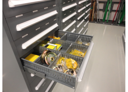

One of the first decisions was to scrap the legacy bin system and replace the bins with drawers and cabinets to store all of the smaller parts. That allowed Premier not just to better organize the space, but to do it in about two-thirds of the footprint of the previous location. "We didn’t want to spend more on square footage than we needed," said Brubacher.
"We found the cabinet route was beneficial as we were consolidating into a smaller space."
By going from smaller bins to deeper drawers and cabinets, they were able to reconfigure not just the space the parts were in, but also the aisles around the parts. "The main change was really that we had a lot more cabinets," Brubacher said. "We purchased 56 cabinets and had the shelving on top of cabinets. The big gain was less aisles. All of our little parts had been in 12-in.-deep bins, and now they were in drawers that were about 30 in. deep. That meant a lot fewer aisles with deeper cabinets. It’s very neat and tidy, less walking."

And rather than wait for the move to switch from the bin system to the cabinets, Premier decided to start the moving process well before the actual moving day. "A huge things for us, and we’re glad we did it this way, is that we set up all cabinets at the old location and then filled them before the move," he said. "We actually filled all the bins with the parts at the old location. It was a tight squeeze for a while. We had to find room for our existing bins and then fill 56 cabinets. We worked three-quarters of the year having one to two people gradually fill cabinets. Then when moving day came, we just moved all the cabinets in an evening and we were ready to go the next day.
"We were filling orders in the old space, but we had all the new aisles laid out," Brubacher said. "We had the new bin locations even in the old building. The guys learned the bin system and when we got into the new location, it was just in different physical spot."
