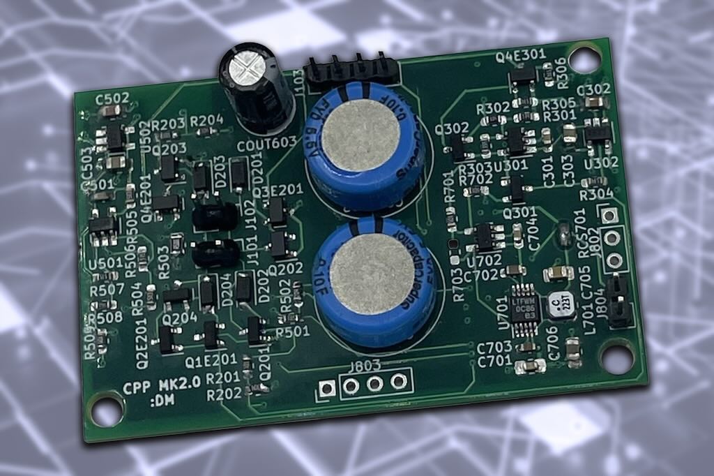

This energy management interface is the "brain" of a self-powered, battery-free sensor that can harvest the energy it needs to operate from the magnetic field generated in the open air around a wire.
This energy management interface is the “brain” of a self-powered, battery-free sensor that can harvest the energy it needs to operate from the magnetic field generated in the open air around a wire. Courtesy: Massachusetts Institute of Technology (MIT)
Self-powered sensor
Using this design framework, they built an energy management circuit for an off-the-shelf temperature sensor. The device harvests magnetic field energy and uses it to continually sample temperature data, which it sends to a smartphone interface using Bluetooth.
The researchers used super-low-power circuits to design the device, but quickly found that these circuits have tight restrictions on how much voltage they can withstand before breaking down. Harvesting too much power could cause the device to explode.
To avoid that, their energy harvester operating system in the microcontroller automatically adjusts or reduces the harvest if the amount of stored energy becomes excessive.
They also found that communication — transmitting data gathered by the temperature sensor — was by far the most power-hungry operation.
“Ensuring the sensor has enough stored energy to transmit data is a constant challenge that involves careful design,” Monagle said.
In the future, the researchers plan to explore less energy-intensive means of transmitting data, such as using optics or acoustics. They also want to more rigorously model and predict how much energy might be coming into a system, or how much energy a sensor might need to take measurements, so a device could effectively gather even more data.
“If you only make the measurements you think you need, you may miss something really valuable,” Leeb said. “With more information, you might be able to learn something you didn’t expect about a device’s operations. Our framework lets you balance those considerations.”
