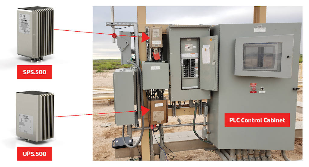

The original central power supply was 120V or 220V to power pumps and an AC-DC converter uninterrupted power supply (UPS) that provided 24Vdc power to the PLC cabinet and process elements. When something tripped the primary power supply the AC-DC converter was wired to, each primary power supply reduced power to 24Vdc for a backup battery bank of two 12Vdc bat­teries wired in series.
The power system sat under a shaded structure in an unclassified area. Shade protected the equipment from sun and rain, but the support structure itself was open on three sides. Operating temperatures cycled between 15°F and 130°F, which contributed to failure and incon­sistent signals. The charge indicator, for example, might show an hour of charge remaining and then drop to five minutes.
Figure 1: PLC control cabinet includes uninterruptible power supply and secure power supply. Courtesy: Bedrock Automation
Also contribut­ing to converter failure was dust ingress from cali­che, a sedimentary rock, which binds with sand, clay, and silt particles to form something cement-like. “We opened one converter and found a thick, dirty mess. No wonder systems were failing,” said Moore, “regular maintenance was required.”

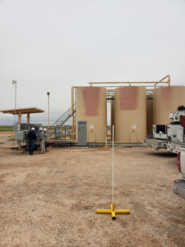

Locating the upgrade in a non-classified area was considered, but that would require a new rack, additional labor and underground cables. Instead they installed new power supplies in a rack already wired with room to spare. But, in a classified area, new equipment had to be rated for Class 1 Division 2 hazardous locations.
Figure 2: Tank area controls infrastructure could accommodate upgraded power system, but required certification for use in Class 1, Division 2 hazardous locations.
Figure 2: Tank area controls infrastructure could accommodate upgraded power system, but required certification for use in Class 1, Division 2 hazardous locations. Courtesy: Bedrock Automation
The combination of Bedrock Automation’s Secure Power Supply (SPS.500) and Uninterruptible Power Supply (UPS.500) fit the bill.
The Bedrock SPS.500 SPS. 500 provides single or redundant supply, using 90-264 Vac AC main volt­age 50/60 Hz input and is fully certified for use in Class 1, Division 2 locations. Its output of up to 500 watts is soft­ware configu­rable between 21 to 28 volts. Multiple sys­tems can be daisy chained to scale up for higher power requirements. The Bedrock UPS.500 works in tandem with the SPS 500 and provides 24 Vdc at 12AC of backup power for up to 2 hours of consistent backup. An onboard secure microcontroller controls the Li-Ion polymer battery cell-by-cell, augmenting the high density, rapid charging, extreme temperature tolerance and extended life that characterizes Li-Ion technology. The Li-Ion technology also recharges 10 times faster than a conventional lead acid battery system. The UPS.500’s high energy density and compact footprint contributes to Occidental Petro­leum’s ability to fit it into available rack space.
In Figure 2, the SPS.500 is mounted above the UPS.500, with the junction box in between. The junc­tion box sends power to the control panel to the right, with the PLCs and relays to the pumps and other field devices. The system’s basic configuration has run flaw­lessly at both location since 2019.

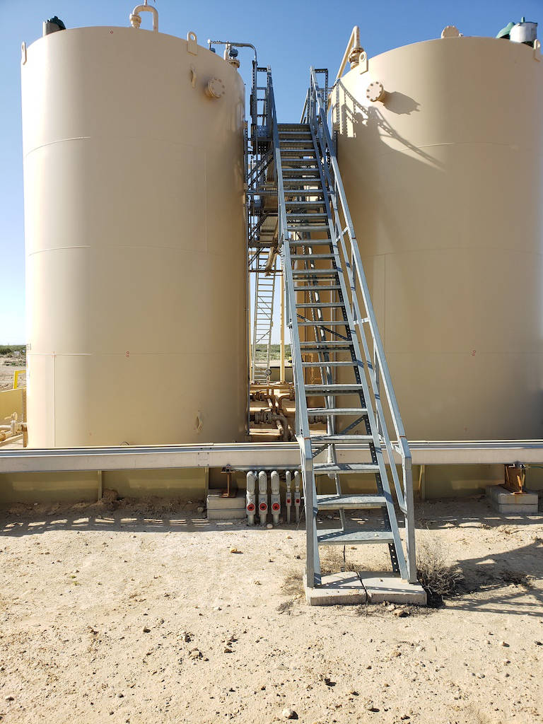

Figure 3: The PLCs that control pumping on these Occidental Petroleum storage towers require secure, reliable power. Courtesy: Bedrock Automation
