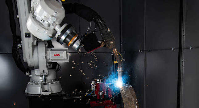

Robotic WAAM for spare parts
Meanwhile in the Netherlands, robots are shaping our additive future.
Renowned for using robots to 3D print a steel bridge, an Amsterdam-based startup now spans the industrial landscape. Metal 3D printing company MX3D is using robotic additive manufacturing to demonstrate the advantages of 3D printing large-scale metal parts, including replacement parts for heavy industry.
In cooperation with ABB Robotics, this robot arm was 3D printed in stainless steel using an advanced version of MX3D’s WAAM technology and MetalXL CAD-to-print software to build complex geometries. With continuous 24/7 production, the 73 kg reengineered part can be printed in 4 days. Following precision machining of the component connections, the part was reinstalled on the robot to demonstrate functionality.
“Compared to powder-based technologies, robotic WAAM enables faster, larger, more flexible and more affordable 3D metal printing,” said René Backx, chief commercial officer at MX3D. “This allows for rapid, automated production of large-scale parts that normally require extensive tooling and overseas production, causing long lead times and limited customization options.”
Rapid metal 3D printing with industrial robots could allow heavy equipment manufacturers and sellers to manufacture spare parts in-house, even robot arms.
