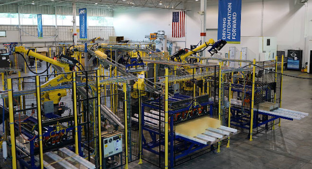

A recent automation project by Applied Manufacturing Technologies (AMT) involved adding robotic material handling and custom automation for a thermoforming customer in the food & beverage industry. The automation was designed to fit between and connect to two existing manufacturing processes on multiple production lines in a 24/7 operation (see Figure 1). While the basic process appeared to be straightforward, the details and unexpected variants in the product and application proved otherwise. This eventually required a human-machine interface (HMI) to help tune and streamline the process.

The first area of the automation project was intended to receive product from a continuous forming and trimming operation, separating the accumulated product into sleeves that can be handled by a robot for delivery to a conveyor system that feeds an upstream process. The control and mechanics of the system were designed to support what appeared to be a straightforward process. What AMT learned as it implemented the automation in production is the variation in the product being handled caused by line-specific equipment, environmental factors (temperature, humidity and the like), and the base material itself, required more controls logic and input/control by the operators. In addition, the system’s design had to fit within existing plant and equipment layout. This resulted in each automation line requiring a unique design while performing the same functions (see Figure 2).
