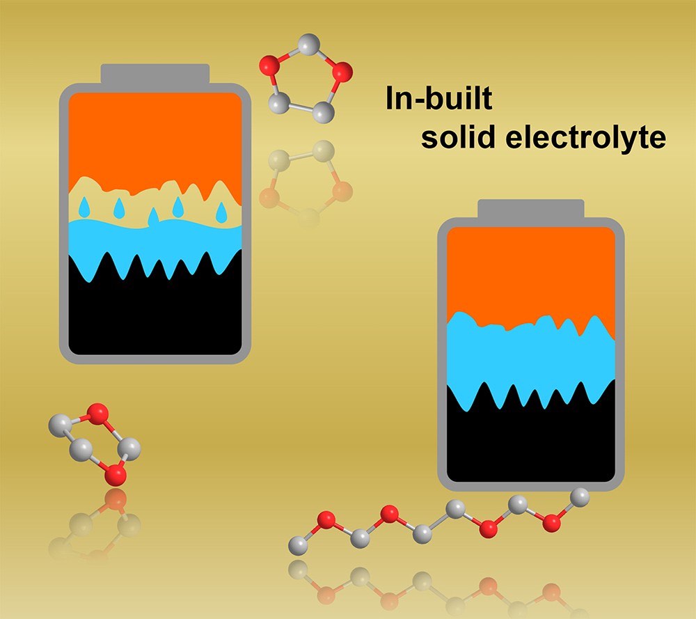

Cornell University researchers have advanced the design of solid-state batteries by transforming liquid electrolytes into solid polymers inside the electrochemical cell.
Cornell researchers have advanced the design of solid-state batteries, which are safer and more energy-dense than lithium-ion batteries.
By starting with liquid electrolytes and then transforming them into solid polymers inside the electrochemical cell, the researchers take advantage of both liquid and solid properties to overcome key limitations in current battery designs. This research coincides with industries looking for rechargeable battery technology that can safely power next-generation technology such as electric cars, autonomous vehicles, and robots.
Apart from improving battery safety, solid-state electrolytes enable next-generation batteries that utilize metals such as lithium and aluminum as anodes for achieving far more energy storage than today’s state-of-the-art battery technology. In this context, the solid-state electrolyte prevents the metal from forming dendrites, a phenomenon that can short circuit a battery and lead to overheating and failure.
“Imagine a glass full of ice cubes: Some of the ice will contact the glass, but there are gaps,” said Qing Zhao, a postdoctoral researcher, in a press release announcing the discovery.” She is also lead author on the study, “Solid-State Polymer Electrolytes With In-Built Fast Interfacial Transport for Secondary Lithium Batteries.”
“But if you fill the glass with water and freeze it, the interfaces will be fully coated, and you establish a strong connection between the solid surface of the glass and its liquid contents,” she added. “This same general concept in a battery facilitates high rates of ion transfer across the solid surfaces of a battery electrode to an electrolyte without needing a combustible liquid to operate.”
