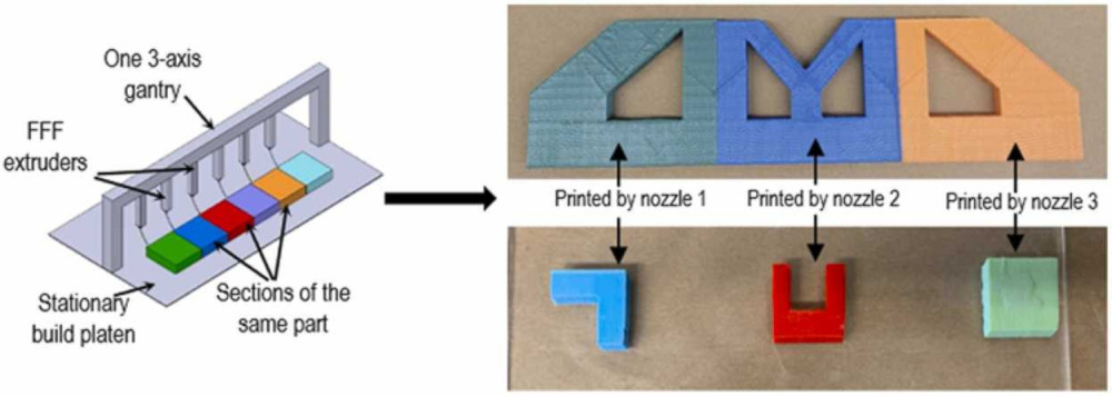

Rutgers engineers have created a way to 3D print large and complex parts at a fraction of the cost of current methods. The approach, called multiplexed fused filament fabrication (MF3), uses a single gantry, the sliding structure on a 3D printer, to print individual or multiple parts simultaneously. By programming their prototype to move in efficient patterns, and by using a series of small nozzles  rather than a single large nozzle, as is common in conventional printing  to deposit molten material, the researchers were able to increase printing resolution and size as well as significantly decrease printing time.

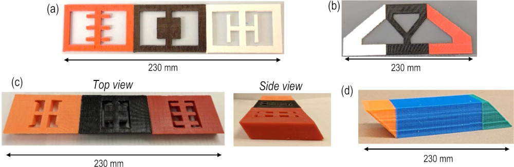

Parts printed with the MF3 prototype using a 0.4 mm diameter nozzle. Courtesy: Rutgers University

At the heart of MF3’s innovation is its software. To program a 3D printer, engineers use a software tool called a slicer  computer code that maps an object into the virtual “slices,” or layers, that will be printed. Rutgers researchers wrote slicer software that optimized the gantry arm’s movement and determined when the nozzles should be turned on and off to achieve the highest efficiency. MF3’s new “toolpath strategy” makes it possible to “concurrently print multiple, geometrically distinct, non-contiguous parts of varying sizes” using a single printer, the researchers wrote in their study.
An MF3 printer has built-in resiliency because the nozzles can be turned on and off independently, making it less prone to costly downtime. Another benefit is a malfunctioning nozzle can be assumed by another nozzle on the same arm instead of halting production in a traditional printing process.
