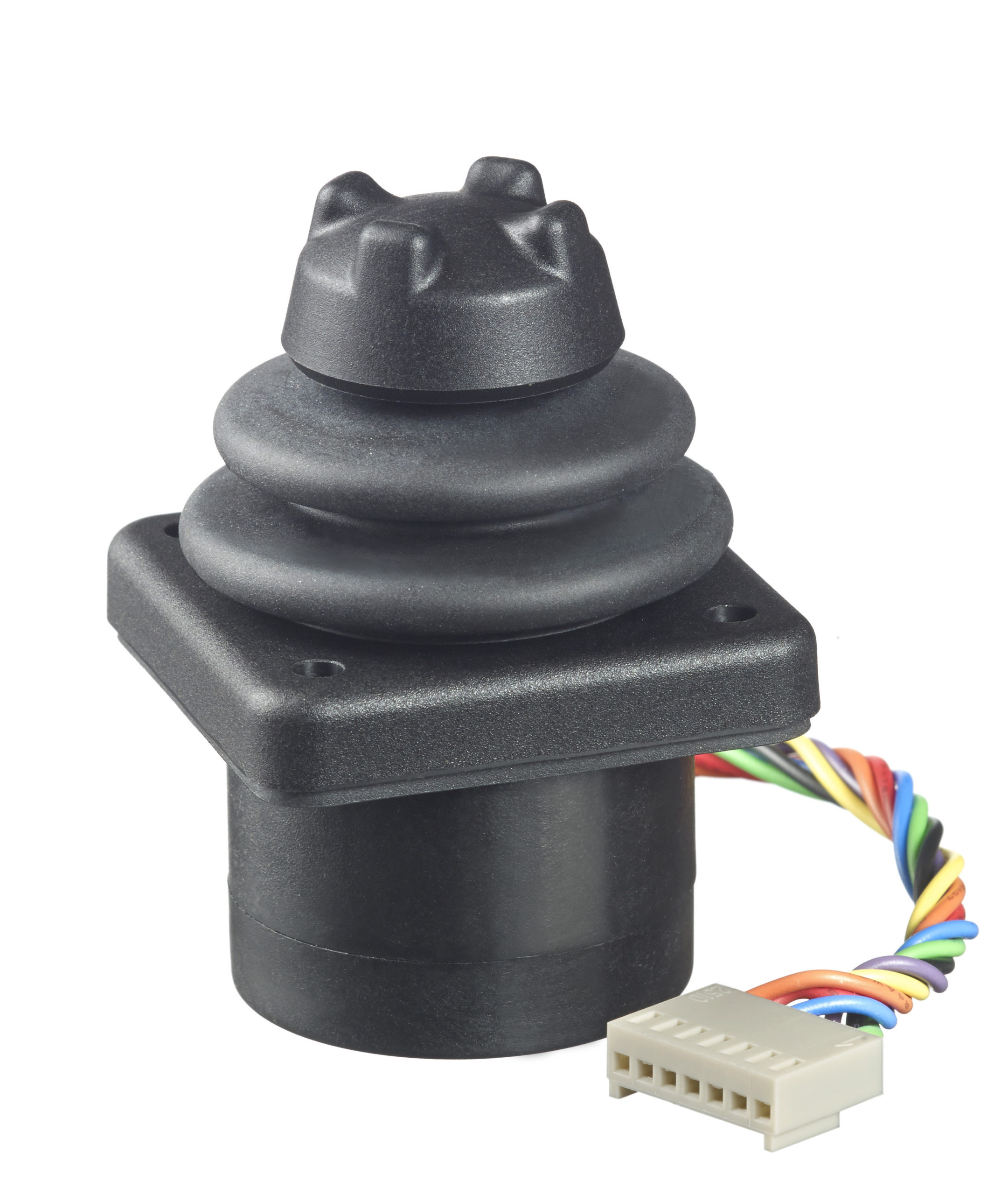

Many of the most challenging industrial, commercial, and marine applications incorporate extensive operator control interfaces, via wired or wireless consoles, armrests, belly boxes, and pendants. Users need responsive multi axis devices supporting precise control, designed to survive the harsh environment. Because these installations have limited space, APEM has developed the XS Series with these manufacturers, OEMs, and end users in mind.
XS Series joysticks are three axis—X, Y, plus Z center tap—with a minimized yet very usable height. The compact size of just 47mm overall height above the panel face is one of the lowest available, making the joystick less vulnerable to impact, and allowing it to be located on dense control arrays without restricting access to other devices. The minimal height means that guarding provisions can also be lower on control panels, providing suitable drop protection while avoiding interference with user actions.
Nylon covering a stainless-steel shaft provides a durable and easily gripped surface, and the entire assembly is rated IP66 at operating temperatures from -22 to 185DegF. The two-convolution gaiter is designed so that self-alignment is guaranteed, and no sealing washer is needed.
