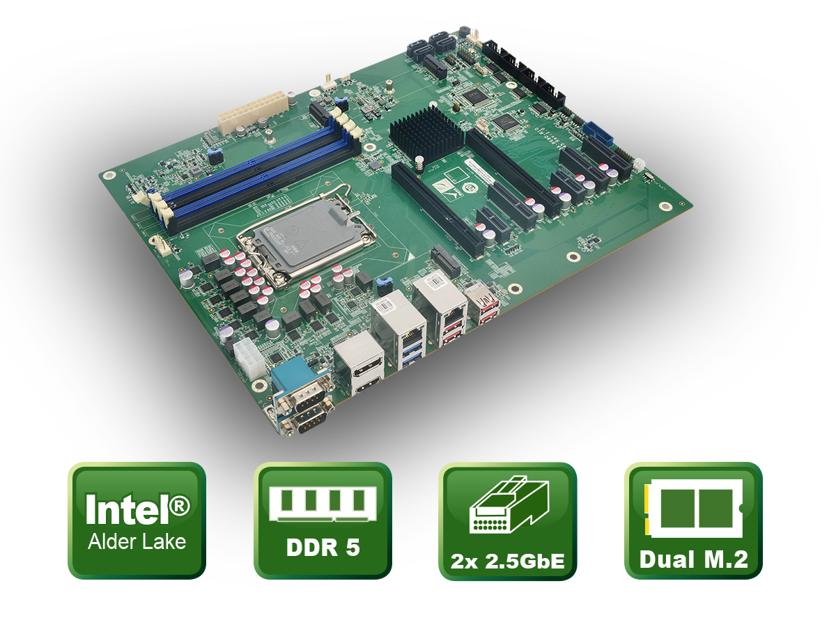

The latest Intel processor generation Alder Lake-S can be operated on the newly introduced ATX motherboard IMBA-R680 from ICP Germany. The IMBA-R680 is equipped with the R680E chipset and supports thirteenth and twelfth generation Intel Core I, Pentium, or Celeron processors. With its four 288-pin DDR5 SDRAM sockets, the IMBA-R680 can accommodate up to 128GB of memory in dual-channel with or without ECC.
For mass storage, the IMBA-R680 has four SATA interfaces supporting RAID configurations RAID 0/1/5/10 and two M.2 2242/2280 (NGFF) M Key slots for NVME x4 SSDs.
The IMBA-R680 has numerous interfaces. Monitors can be connected to an HDMI port, a display port or the iDPM interface, which offers eDP, VGA, LVDS or VBO via adapter boards. Furthermore, two LAN ports with Intel I225V 2.5GbE controllers, eight USB 3.2, four USB 2.0 ports as well as two RS 232/422/485 and four RS-232 interfaces are available for the connection with peripheral devices.
For system expansion, the IMBA-R680 offers two PCIe x16 Gen. 5 slots with x8 signal, as well as three PCIe x4 Gen. 4 and two PCIe x1 Gen 3 slots.
The IMBA-R680-R10 can be used at temperatures from 0~60°C. ICP Germany can also deliver the IMBA-R680 pre-configured with the appropriate CPU and memory or in a suitable 19″ or midi-tower case as a ready-to-use system.
