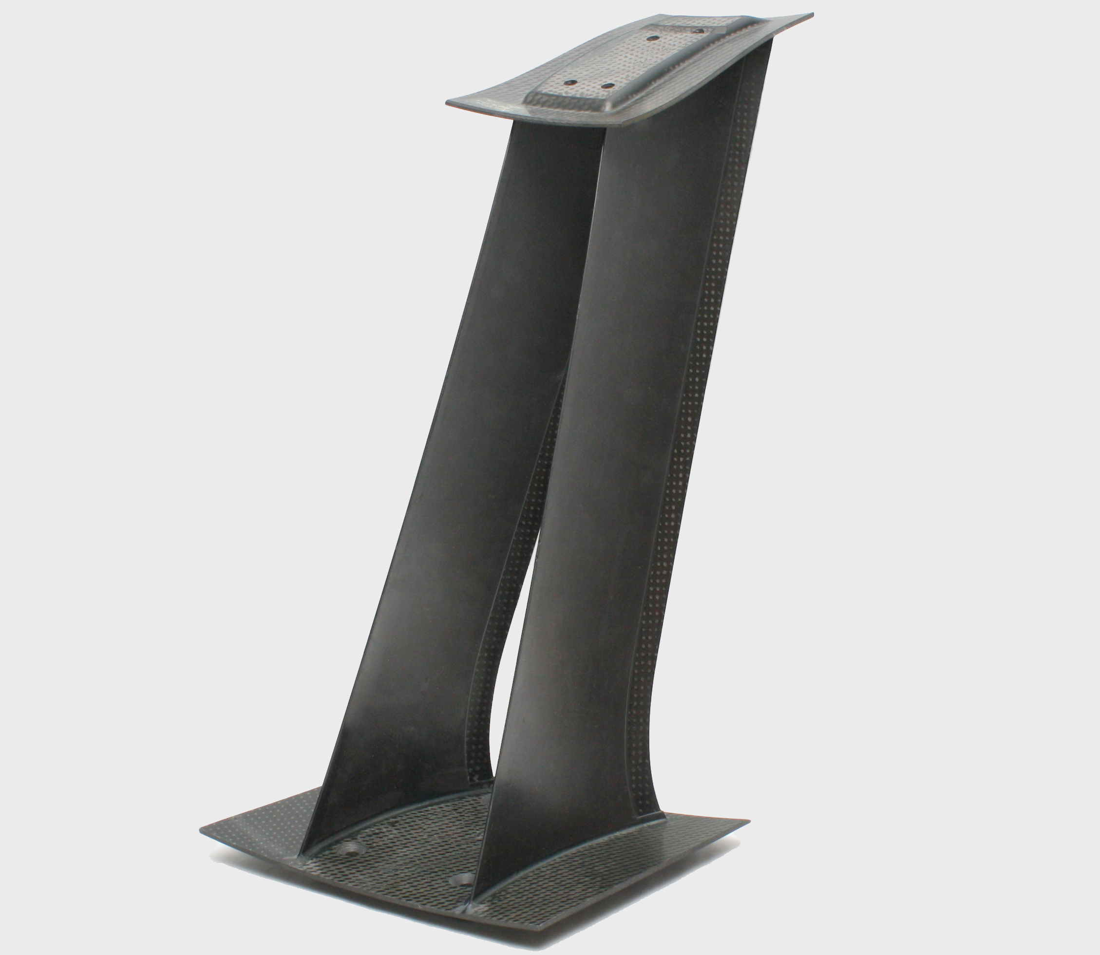

3-D woven components also function well as engine parts in aircrafts. Replacing traditional titanium engine components with 3-D woven carbon fiber composites serves to reduce weight and therefore lifetime cost, all while meeting the rigorous demands of manufacturing and use.
