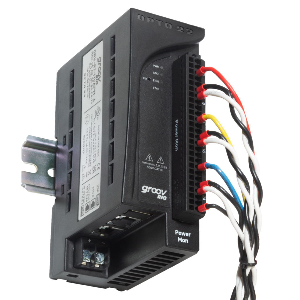

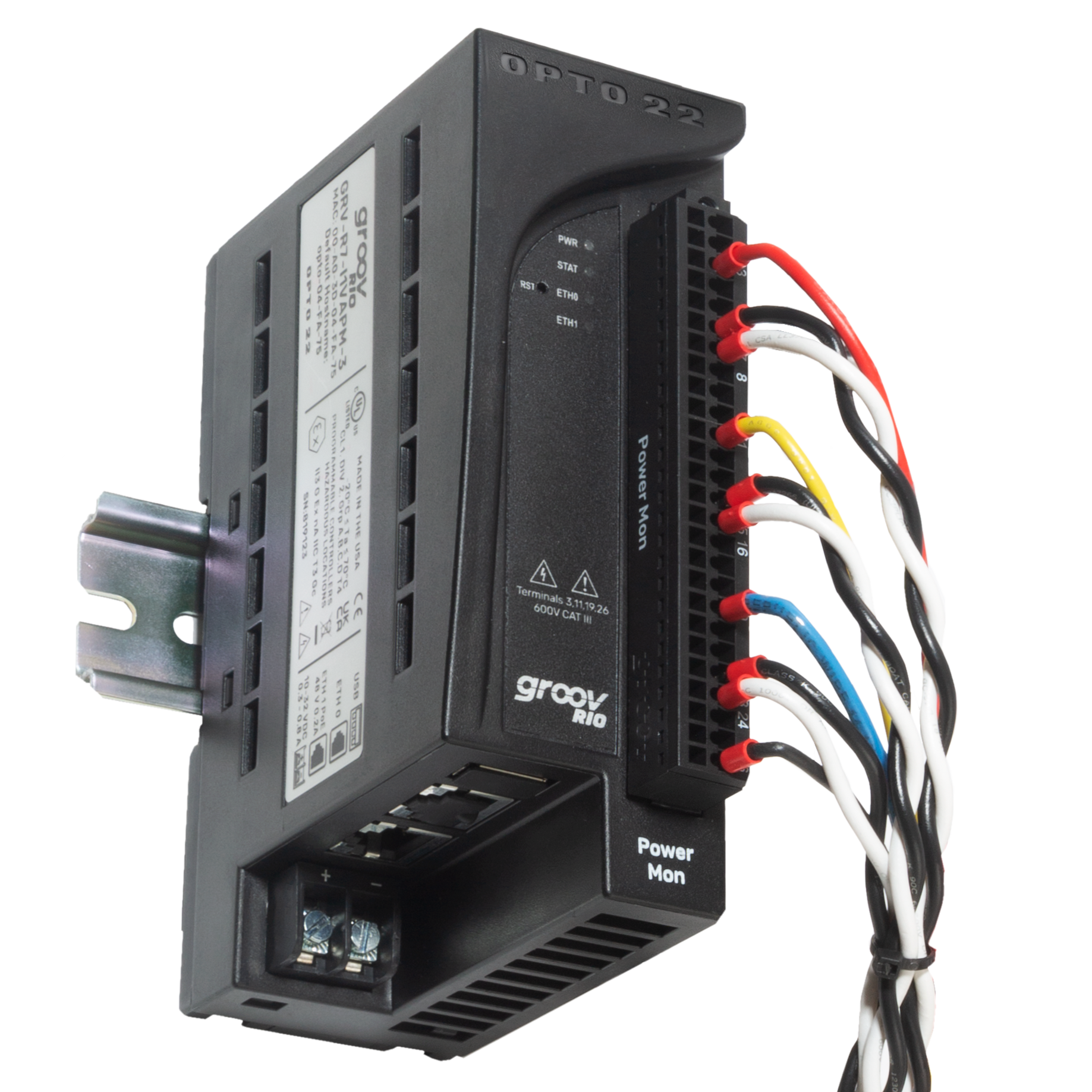

The GRV-R7-I1VAPM-3 is a groov RIO energy management unit (EMU) designed as an intelligent, distributed energy monitoring module. With built-in web-based configuration, commissioning, and flow logic software—plus support for multiple OT and IT protocols—the groov RIO EMU offers the flexibility to fit into either IIoT projects, especially those that require energy data acquisition or communications, or traditional energy management control systems. The groov RIO EMU simultaneously measures volts AC RMS and amps AC RMS on Category III wye (up to 400 VAC) or delta (up to 600 VAC) circuits. It can monitor three-phase AC current using 0.333 V, 1 V, or 5 A current transformers (CT). Each phase can be configured to ignore signals below a specified threshold in power measurement and energy accumulation to help you tune signal accuracy. From the two measured field inputs, the module automatically calculates a total of 64 data values, including voltage and current; true, reactive and apparent power; power factor, frequency, net energy, and other values, as well as accumulated energy values for all phases.
