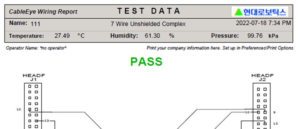

CAMI Research Inc. (Acton, MA), manufacturer of the CableEye automation-ready cable and harness test system, has released an environmental sensor option incorporating the Dracal PTH200 sensor. Of particular interest to medical and defense applications, this option provides automatic measurement and reporting of environmental test conditions (temperature, relative humidity, pressure) alongside electrical function data for the cable, harness or backplane under test. This option simplifies test and reporting procedures especially involving testing with environmental chambers.
Set up your test station to perform multiple background tasks, including environmental data acquisition, all triggered automatically with a single click of a button or a barcode scan.

The new add-on option comprises custom software and a Dracal environmental sensor that connects to a USB port on the tester’s computer. CAMI’s accompanying custom software reads the data into variables within the main tester software.
