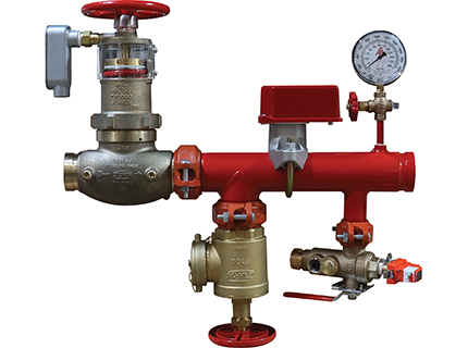

The AGF Commercial RiserPACK Model 8511Z is meticulously crafted in the USA using high-quality schedule 10 pipe, ensuring superior durability and performance. This assembly incorporates the AGF Model 2511 TESTanDRAIN valve with a pressure relief valve and drain trim, flow switch, pressure gauge, and AGF Universal 3-way gauge valve, along with a 2 ½” hose valve. The 8511Z manifold was designed specifically for floor control applications where a downstream drain outlet, capable of full flow is required for Pressure Reducing Valve acceptance testing and future inspection and testing requirements. The integration of the Zurn ZW5004 Valve adds another layer of functionality and versatility to the AGF solution. The ZW5004 Valve is a 2-1/2" Pressure-Tru Valve featuring an angle body and grooved connections. Certified as a floor control valve, an indicating valve, and a check valve in automatic sprinkler systems, it is also listed as a standpipe valve for CLASS I and CLASS III systems. With the ability to regulate pressure under both FLOW and NO-FLOW conditions, the ZW5004 Valve offers precision and control. Field adjustments are made effortlessly thanks to its low torque design, requiring only 9 ft lb of torque. Despite its compact profile, the larger handwheel ensures smooth operation, even in tight spaces.
