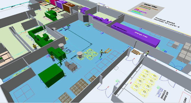

Process modeling of a new design can provide the right number and size of necessary processing and supporting equipment. This is particularly valuable for equipment shared by multiple-unit procedures such as clean-in-place (CIP) skids, utility system designs and powder bins and tablet totes in an oral solid dosage (OSD) facility. The overall production process may have an equipment bottleneck; the model will identify the bottleneck and ensure it does not constrain production to a value less than the business objectives for the facility.
The model also will examine other potential bottlenecks. If their constraint is close to the desired bottleneck, then schedule disruptions or other variability may result in a constraint lower than the design, effectively substituting a more restrictive bottleneck for the desired one.
Changes occur frequently during the design process. Engineers find better alternatives and management may change the product mix of volumes the facility will be expected to make. In these instances, having a process model of the design is especially beneficial. The model can be used to evaluate the alternatives and ensure the changes are cost effective while maintaining the desired throughput. Staffing levels and shift schedules can also be compared with a model. This helps with cost justification of the design change.

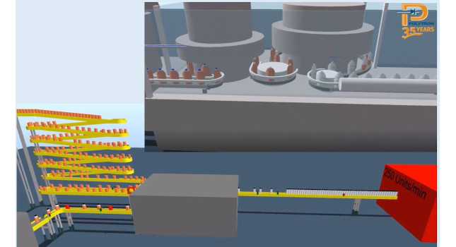

CTL2005_MAG2_IMG_IP_CRB_Simulation: A process model is a computer representation of a real-world system or process. Courtesy: CRB
CTL2005_MAG2_IMG_IP_CRB_Simulation_ATMPFacility: Process modeling of a new design can provide the right number and size of necessary processing and supporting equipment. Courtesy: CRB
