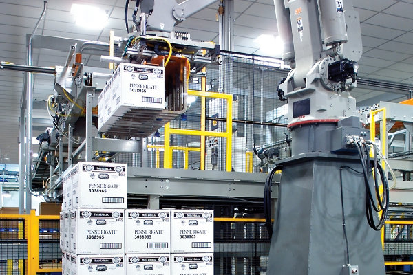

Robotic arm palletizers are a legitimate solution for high-SKU, lower-speed operations as well as applications where the product shape demands the precision of a robotic arm, such as bags and pails. Robots pick and place the product, while conventional palletizers convey the product into position. For items such as pails and bags, the ability of a robotic arm to precisely place the product is very important. Pails must “nest” together on the lid of the pail below when stacked on a pallet, and bags must be gently placed straight and square without disturbing contents. Additionally, robots have the ability to work in confined spaces and dusty environments, adding to their appeal for the bag palletizing applications.
