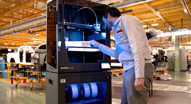

Automotive manufacturer Nissan integrated 3D printing into its production process at the Nissan Barcelona factory using BCN3D, a Spanish 3D printing solutions manufacturer. By printing some parts in-house with 3D printers, Nissan has cut the time of designing, refining and producing parts from one week to one day and slashed costs by 95%. Nissan is printing 3D materials in plastic and is trialing metal. A BCN3D video shows how the Nissan Barcelona factory uses 3D printing to manufacture final parts and prototypes on its assembly line for vehicles, including for the Nissan Navara 4×4 pickup truck.

The car manufacturer has been using BCN3D 3D FFF (fused filament fabrication) technology to create tools, jigs and fixtures for its manufacturing line in Spain, according to information from BCN3D.
Nissan created 700 3D printed parts so far, with some costing as little as 3.45€ to manufacture.
Nissan previously outsourced all prototypes and jigs to mechanical suppliers who used traditional manufacturing methods, such as computer numerical control (CNC) and drilling. Lead times were long and inflexible, and even simple tools could cost near 400€ for machining.

Nissan’s additive manufacturing laboratory has four BCN3D printers, incorporate an Independent Dual Extrusion (IDEX) system, which means Nissan can print two identical components at the same time, doubling productivity.
Nissan used the BCN3D Smart Cabinet to preserve filament printability, extend its shelf life, reduce aesthetic defects and avoid costly reprints.
Carlos Rellán Martínez, manager of maintenance and engineering facilities at Nissan Motor Ibérica Zona Franca, Barcelona, said: “The performance achieved in terms of reliability has been excellent. Our printer runs nearly 24 hours a day and every year we’re printing around 100 different jigs and tools for specific use in our processes.
Mechanical supplier outsourcing was 20-times more costly than 3D printing
“Outsourcing tools to a mechanical supplier was 20 times more expensive than 3D printing the same parts, while the wait for tools went from a week down to one day. By introducing 3D printing, we have increased added value and generated low costs, without high delivery times. We have paid off the investment in the printers very quickly,” Martínez said.
The Nissan team has used BCN printers to produce a multitude of products, including a tool to fix a windshield centering gauge, a lower drill positioning tool and a jig to position and cure the model name on the vehicle. The fixing tool was made of TPU, cost 8€ and took 14 hours to print. The positioning tool was made of ABS, took 15 hours to print and cost 21.50€. The jig was created from ABS, took 12 hours to print and cost just 3.45€.
