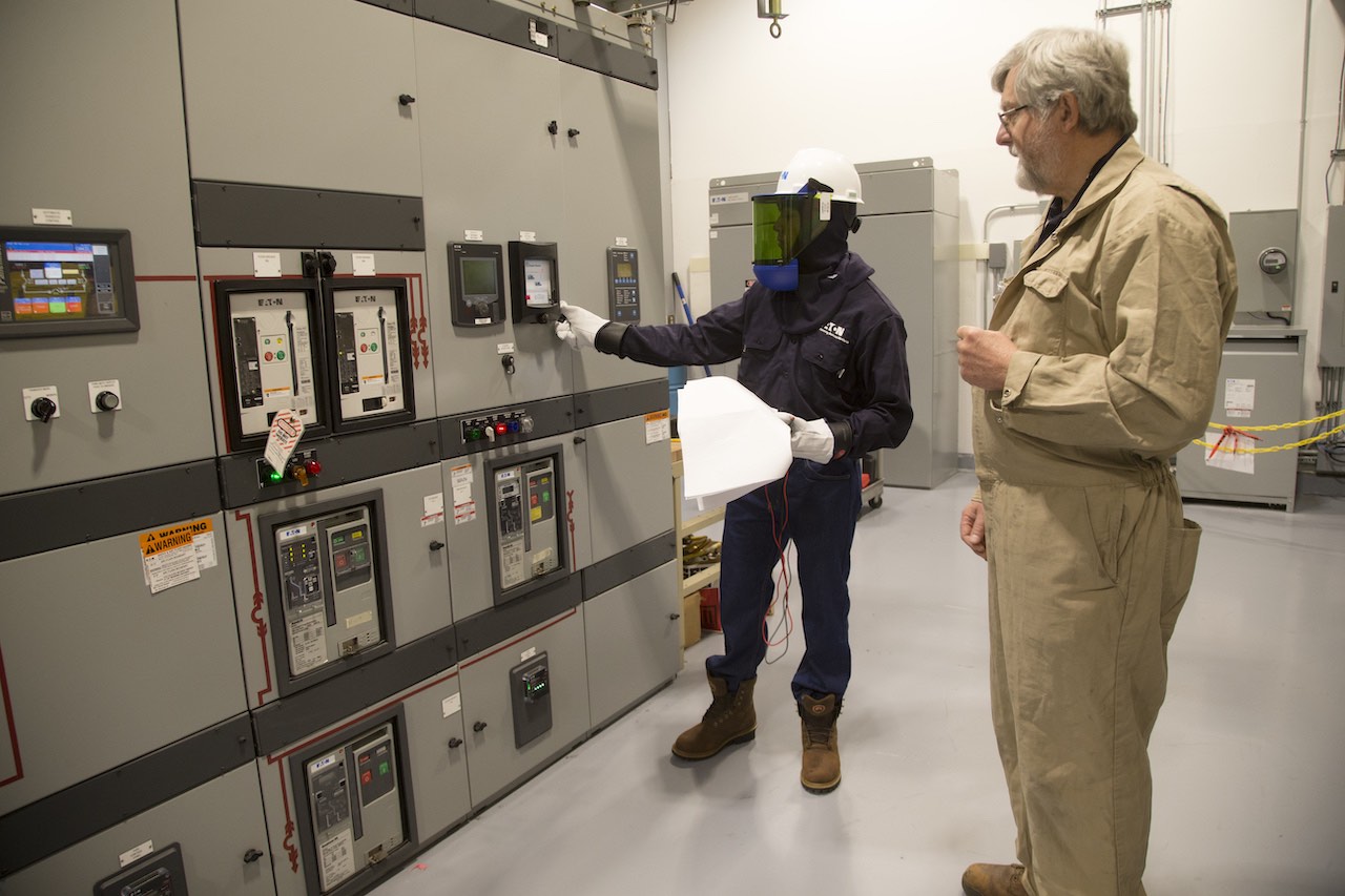

To further illustrate risk, consider an electrician at a manufacturing plant operating a circuit-breaker disconnect on a 480 V low-voltage motor control center (MCC) with the enclosure door closed. The likelihood of a shock injury is near zero, with no exposure to energized conductors, and the likelihood of an arc flash event is extremely low. Now consider a task where the electrician is using a multi-meter to test phase voltages with the MCC enclosure door open. The hazard is the same, but the risk of electrical injury from shock hazard and arc flash is higher because the electrician is exposed to energized conductors.

NFPA 70E requires an exhaustive risk assessment before energized work begins—a great safety advancement. A risk assessment reviews electrical hazards, the planned work task, and the protective measures required to maintain an acceptable level of risk. In practice, this means scheduling a work-plan meeting to discuss and document issues for the task at hand, the tools required, maintenance history of the equipment, test records of the equipment requiring energized work, and the calculated amount of heat-energy exposure. The following summarizes the steps technicians should follow before performing energized work:
