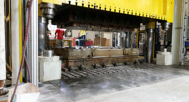

A recent retrofit project at a manufacturer and rebuilder of hydraulic presses involved the upgrade of the press controls on four older hydraulic presses before installing them at a truck component manufacturing plant in Monterrey, Mexico. The 2,340-ton presses, originally manufactured by Hoesch in Germany, use two main cylinders (1,170 tons each) for the moving platen and four leveling cylinders (125 tons each) to mold and in-mold coat large glass fiber body parts for trailer truck cabins (see Figure 1).
Before arriving at Macrodyne Technologies Inc. of Concord, Ontario, for refurbishing, the presses had been disassembled and all electrical controls were removed. Macrodyne could choose what control system to use in the press rebuild. The moving platen would be controlled through a new programmable logic controller (PLC), and the levelling cylinders would be controlled by a new electrohydraulic motion controller.

  2. Leveling system force control to achieve precise, total resistance force. During the operation, the moving platen and bolster (visible in Figure 2) are kept parallel through velocity and force profiles and also through the injection of IMC for even part coating.
