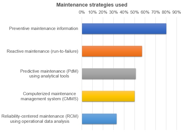

- Maintenance strategies: Eight in 10 manufacturing facilities follow a preventive maintenance strategy; 57% use a run-to-failure method and 51% practice a predictive maintenance (PdM) approach using analytical tools.
