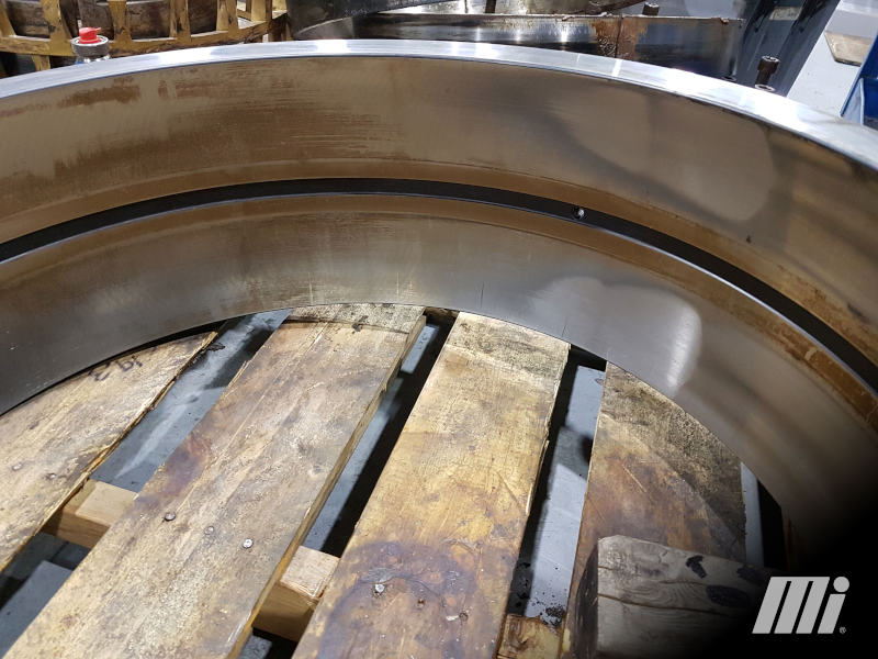

This outer ring raceway shows roller skidding when entering and leaving the load zone. This is suspected to be caused by prolonged periods of reduced loading in conjunction with overlubrication. Instances of reduced loading of a cylindrical bearing application combined with excessive grease will increase the likelihood of skidding. Courtesy: Motion.

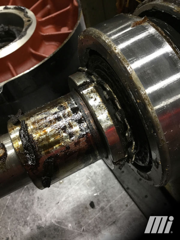

Overgreasing creates additional heat and failure of equipment, as shown here. This motor bearing and shaft are dripping with grease. Courtesy: Motion.

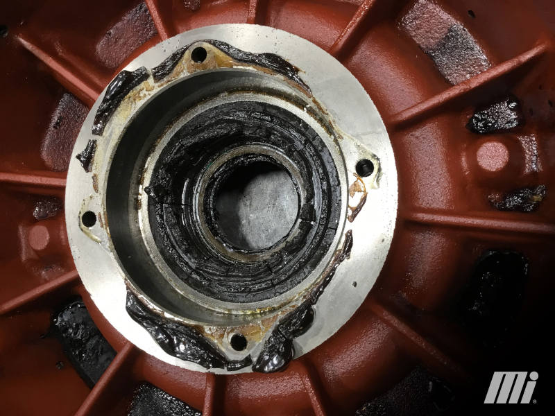

Overgreasing creates additional heat and failure of equipment, as shown here. This motor bearing and shaft are dripping with grease, while one can see the grease-filled motor end bell housing. Courtesy: Motion.
