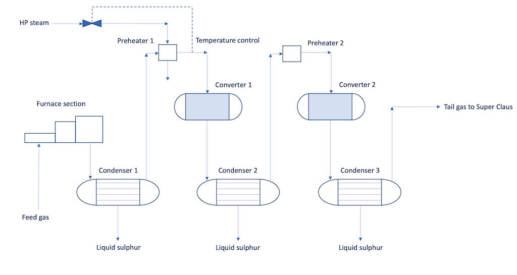

The most common way of producing sulfur is the multi-stage Claus process. A simplified flowchart of this process is shown in figure 1.
Figure 1: This flowchart of the reaction part of a sulfur recovery unit uses the Claus process. Courtesy: TrendMiner
The process has multiple stages because of its chemical equilibrium. A feed gas containing a high concentration of H2S must be pre-heated using steam. The gas then enters the first converter, where it undergoes partial conversion toward pure sulfur. Part of the sulfur is removed from the gas stream before entering the second converter. In the final stage, the pure sulfur is removed and the remaining gas containing small amounts of H2S goes downstream to a treatment plant.

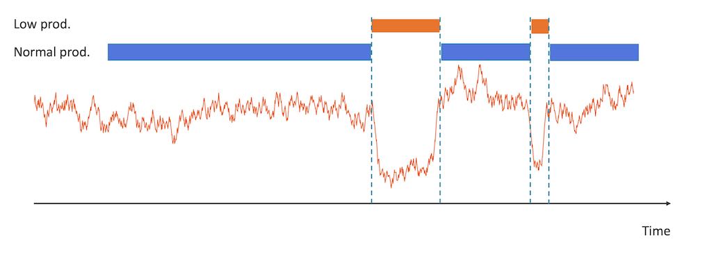

In addition to challenges of entering and storing all process data, time-series data has its own limitations. First, it tends to contain a lot of noise that makes the data hard to read. The noise must be filtered out before the data can be used for analysis. Second, it contains periods of normal operation as well as abnormal operation. Normal operating timeframes can be used to identify a golden fingerprint, or the parameters necessary for ideal process behavior. When evaluating for anomalies, however, normal periods of operation also need to be removed.
Therefore, the first question should be, “Is the process running normally?” For a simple answer, engineers can use a Gantt chart to highlight periods of low production in the time-series data. In the case of Figure 3, only the areas in orange are interesting for the analysis.
For a quick analysis, this graph provides a simple solution to monitor periods when the process was not operational. Engineers can perform this exercise for all the relevant time-series data.
Figure 2: The trend line represents absolute sulfur production (in tons/day), while the Gantt chart shows periods of normal and low production. Engineers can use this graph to show just the period they need to evaluate time-series data. Courtesy: TrendMiner

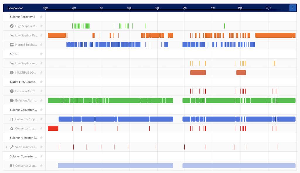

The report created during Step 2 needs to be extended before applying prescriptive analytics. Extending the report includes adding tags that note measurements of sulfur yield, H2S concentration, chemical converter parameters, and so forth. Figure 3 shows a Gantt chart that contains all relevant contextual data necessary to perform the root analysis in earlier steps. For example, the left column shows extra parameters, such as sulfur converter 1, outlet measurement of H2S gas, sulfur re-heater, and others.
Figure 3: The graph above shows an extended report of contextual items necessary to complete a root cause analysis of the sulfur recovery unit. Courtesy: TrendMiner
In the advanced analytics solution, the reports associated with these events provide descriptive information that explain what happened. The time-series data also provides the answer to the question, “when.” Furthermore, it provides a list of things to check when the event occurred to determine why.
For example, in the case of low sulfur production, process experts see that the first thing to check is sulfur yield. If the yield is low, engineers need to intervene only when the alert associated with the monitor has tripped multiple times. If it has, process experts can get a list of instructions and a checklist that will tell them what to look for to correct the anomaly.
