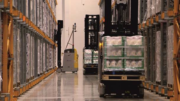

Figure 1: The latest high-performance LGVs for pallet movement offer improvements in battery performance, energy utilization, vehicle uptime, CO2 reduction and enable a more integrated and space-optimized facility.
Figure 1: The latest high-performance LGVs for pallet movement offer improvements in battery performance, energy utilization, vehicle uptime, CO2 reduction and enable a more integrated and space-optimized facility. Courtesy: E80

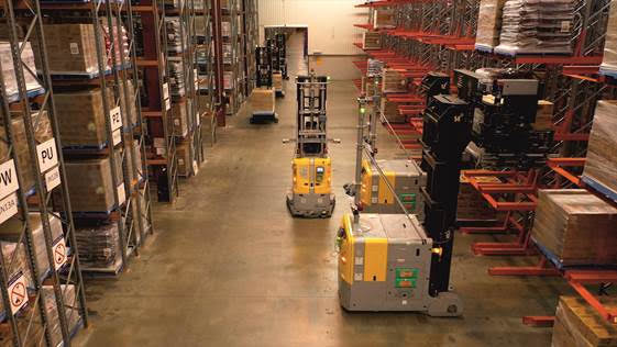

Figure 2: LGVs are designed to handle various pallet types with loads up to 3,400 lbs.
Figure 2: LGVs are designed to handle various pallet types with loads up to 3,400 lbs. Courtesy: E80
LGVs provide for movement of pallets between integrated functions in manufacturing and distribution. Interfacing with multiple systems, LGVs enable reliable raw material and product handling, with near zero potential for product damage. Using a combination of logic software and wireless navigation, LGVs can perform tasks not possible with other transport systems such as the uniform movement and positioning of pallet loads to within a fraction of an inch of their designated targets, without noise and with a high degree of safety for workers and their operational environment.

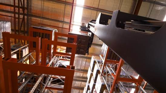

Designed to handle various pallet types such as CHEP, EURO, blockpallet and stringer with load requirements up to 3,400 pounds, these LGVs can accommodate single-deep and double-deep racking with a telescope fork. Using a satellite remote unit, lane depth can be considerably extended (see Figure 3).
Figure 3: LGVs accommodate single- and double-deep racking, and extended depths with satellite remote units.
Figure 3: LGVs accommodate single- and double-deep racking, and extended depths with satellite remote units. Courtesy: E80

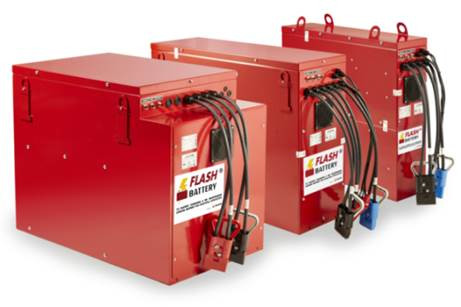

Figure 4: Lithium flash battery technology provides a solution for LGV operation.
Figure 4: Lithium flash battery technology provides a solution for LGV operation. Courtesy: E80
The cells in a lithium battery have different capacities, resistances and self-discharging potential. When one cell is 100% charged, another may be 95% charged. This difference seems small, but it can increase with each charge cycle until it becomes quite large, which lowers the battery’s charge potential and vehicle range.
To prevent loss of charge and reduce balancing and charging cycle time, flash battery electronics acts in active and passive modes to equalize the cells’ charge levels during charging and discharging. This results in 20 times faster balancing and a maximum of 30 minutes in cyclic applications, greatly reducing charge balancing and recharging times.
Supporting the performance of a facility’s fleet of LGVs and its flash battery technology, E80’s Flash Data Center continually monitors and controls every battery of the fleet integrated system. This is to ensure the LGV network keeps its battery potential in peak performance to maintain plant uptime and efficiency.
The control electronics in the lithium flash battery keeps it balanced and efficient, eliminating the need for regular maintenance. The remote monitoring system enables the condition of the battery to be determined at any time while reporting malfunctions.
Lithium flash battery technology eliminates problems connected with lead-acid batteries including high maintenance costs, low efficiency below 75%, short battery life, inability to partially charge and the cost of charging salts and exhaust vacuum systems. A single lithium flash battery is required per LGV, compared to two batteries needed with traditional lead-acid LGV applications. Lead-acid batteries will last from two to three years, compared to lithium flash battery technology, which is proposed to last eight to 10 years.
