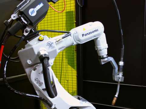

Trouble 1: Poor wire feeding
Causes: There are two key causes to poor wire feeding in a robotic welding system: one, issues with the liner such as debris buildup; or two, an improperly functioning wire feeder, particularly the drive rolls. A third issue, wire cable kinking, can sometimes lead to poor wire feeding performance, too. Regardless of the cause, the result is typically the same: poor arc and weld quality.
Remedies: To prevent and/or address issues with the liner, be certain to change out this component during routine maintenance. Doing so helps prevent debris from building up inside, either from the welding wires or the shop environment.
Using a robotic MIG gun with an “air blast” feature is also very helpful to eliminate debris. This feature blows air through the liner during scheduled downtime in the robotic welding cycle. That downtime may be during a reaming or cleaning cycle and/or during parts changeover. In the absence of an air blast feature, welding operators can also manually blow compressed air through the liner.
If a welding operator suspects that the drive rolls may be the culprits of poor wire feeding, there are two options to assess the situation. One, visually inspect the drive rolls for signs of wear. Over time, these components can become worn and may not guide the welding wire properly. The welding operator  can also conduct a “two-finger” test: Disengage the drive rolls, grasp the welding wire, and pull it through the gun. If the wire pulls through easily, it is likely that the drive rolls are the cause of the poor wire feeding. In both instances, replace the drive rolls as necessary.
Finally, look for kinks in the power cable, as these can also lead to wire feeding problems. Unwind and straighten the cable as necessary.
