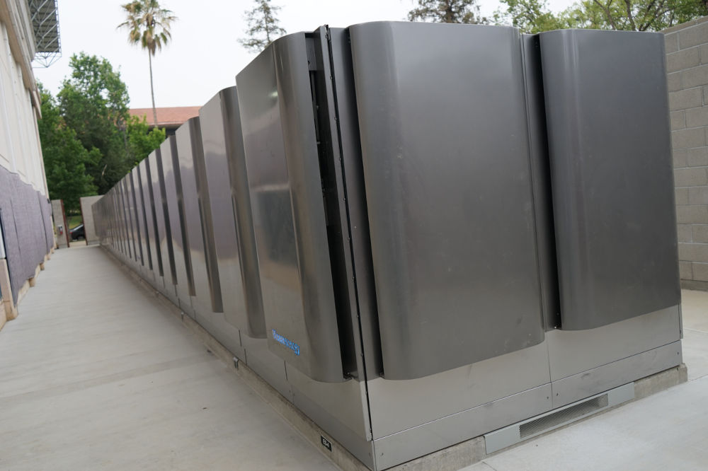

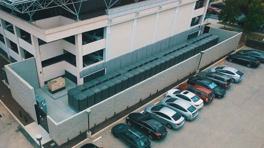

The fuel cell server installed at the California Institute of Technology (Caltech) campus in Pasadena as part of a larger project with SoCalGas. Courtesy: Bloom Energy
