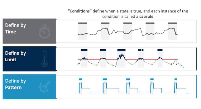

As an example of the challenges found when working with time-series data, consider a simple time-series data set with sensor data recorded every second for a year to create 3.1 million data points, each in the form timestamp:value.
Most likely, the user doesn’t want all the signal data for their analysis; instead they only want to identify time periods of interest within the signal. For example, perhaps the user needs handles to periods of time within the data for analysis defined by:
  • Time period: by day, by shift, by Tuesdays, by weekdays versus weekends, etc.
  • Asset state: on, off, warm up, shutdown, etc.
  • A calculation: time periods when the second derivative of moving average is negative
  • Data samples that are errors: lost signals, flyers, dropouts or other issues that require cleansing to improve analytics accuracy.
In other words, time periods of interest are when a defined condition is true, and the rest of the data can be ignored for the analysis. Time periods of interest may be selected to use as integration points with relational or discrete data types (see Figure 1).
