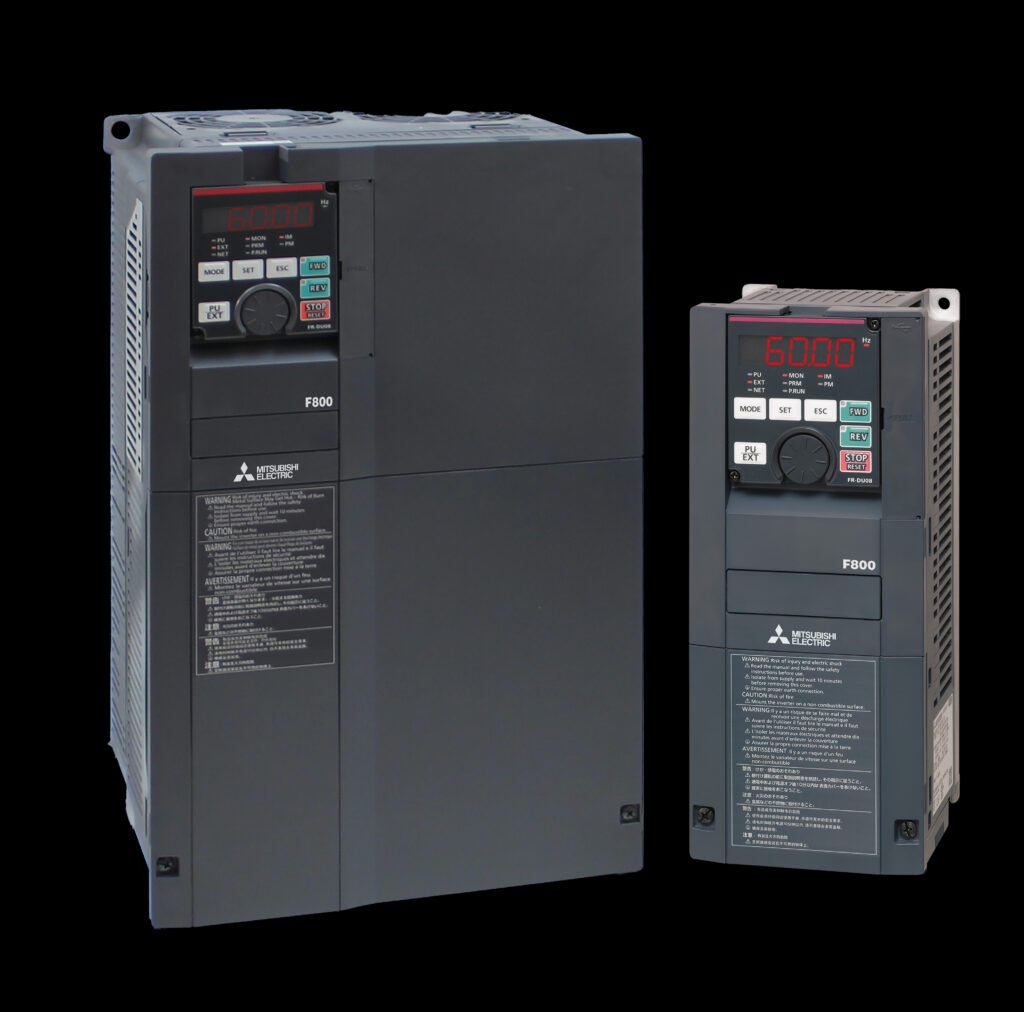

Manufacturing can move forward with automation. Courtesy: Mitsubishi Electric
