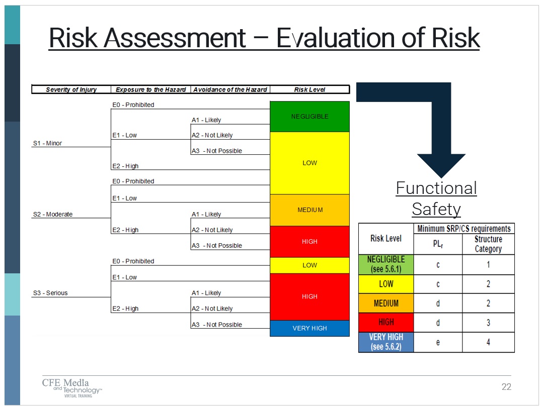

Risk assessment evaluates risk by looking at potential injury severity, exposure to the hazard, ability to avoid the hazard, and risk levels, explains Terry Meister, controls manager at Applied Manufacturing Technologies Inc. (AMT) and chairman of the AMT Safety Committee. Courtesy: Virtual Training Week from CFE Media and Technology and Applied Manufacturing Technology
