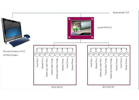

The benefits of monitoring boiler and steam system efficiencies
In the U.S., most plant boilers operate with a fuel-to-steam efficiency of 75% to 85%. This results from stack losses, poor controls and set-up, blowdown losses, losses due to radiation of heat from the boiler, and poor heat transfer due to scaling. The rest of the steam system can then lose up to an additional 30% of energy due to insulation losses, steam leaks, blowing steam traps, flash steam losses, and lack of heat recovery from condensate. Many of these losses can be easily fixed once you know the problem exists. This is where a boiler and steam system efficiency monitoring system can help.
- It will provide percentage figures for fuel-to-steam efficiencies for each boiler, with being data logged over time. This can immediately flag opportunities to improve boiler performance. For example, it’s possible to see the immediate effects of adding an economizer or changing from manual to automated TDS blowdown control. It allows boilers in a plant to be compared with each other and predicted efficiency figures from manufacturers. It also flags new problems with the boiler. Perhaps blowdown was missed or there’s a problem with the deaerator tank because the feedwater temperature has dropped resulting in a drop in the measured efficiency.
- It will provide the steam system efficiency for the entire plant which can also be data logged over time. This allows a comparison to be made against industry benchmarks and between plants. For example, let’s say there are two identical plants, Plant A and Plant B. Their system efficiency figures differ greatly: Plant A’s efficiency is 20% higher than Plant B because at Plant A they have just fixed all of their leaking traps—a 7% efficiency improvement—and started recovering heat from all of their blowdown and flash steam—a 13% efficiency improvement.
- It will provide the cost of producing steam for each boiler and for the plant. Of course, once you know the cost of the steam produced you can estimate the losses you may have when compared to other boilers, plants and benchmarks. This data can then easily be used to help justify system improvements to reduce overall costs.
