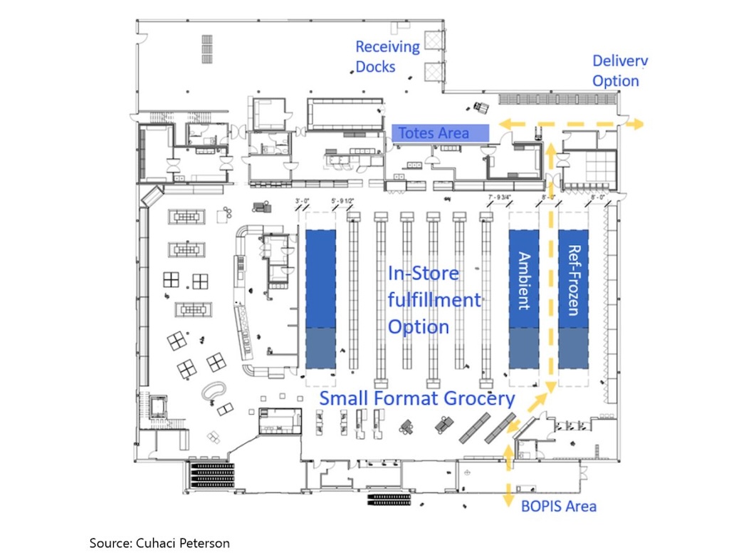

In addition to the bifurcation of convenience and weekly-shop fulfillment models, there is more interest from grocers in deploying center-store automation solutions. Cuhaci Peterson, for example, is working with several grocers on architectural designs to automate the center-store. Furthermore, several of the top 10 grocers in the U.S. confirmed this was in their technology roadmaps. The idea is in-store customers would key the items they want from the center store into a computer monitor (or place the order before arriving), and then spend more time in high-margin areas of the store such as deli counters, pharmacists, cosmetic counters or fresh produce.
Diagram of a center-store fulfillment model.
Diagram of a center-store fulfillment model. Courtesy: Interact Analysis/Cuhaci Peterson
The right-sizing of MFCs, coupled with the use of more central store automation solutions, is expected to have a positive impact on the market.

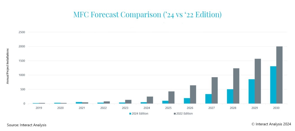

While the perceptions of MFCs are at an all time low, the number of deployments are higher than most realize, with 39 deployments in 2023, up from 33 the year before. Furthermore, the opportunity for MFCs is growing due to the rising demand for shorter delivery times.
Furthermore, the unit-economics remain attractive in the absence of productivity inhibitors and unexpected costs. Assuming MFC vendors address the key barriers to adoption, we anticipate more than 1,000 automated MFCs will be deployed during 2030, up from a peak of 58 in 2021.
The forecast has been revised down, but strong growth is still anticipated in this market.
The forecast has been revised down, but strong growth is still anticipated in this market. Courtesy: Interact Analysis
