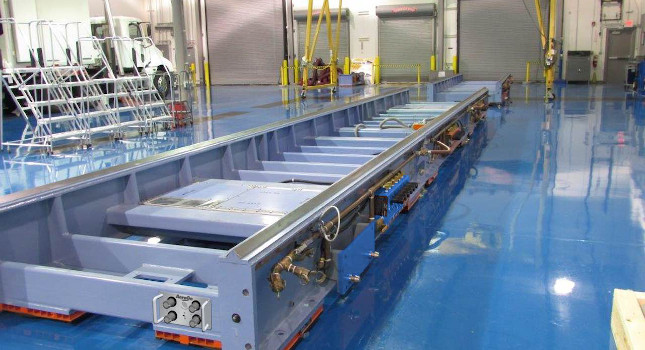

In a plant environment, the ability to move machinery to optimize floor space or flex for lean manufacturing is essential for increasing productivity and profitability. To accomplish that goal, original equipment manufacturers (OEMs) have turned to embedding integrated air bearings or air casters into their machinery and other heavy or oversized equipment for adapting and adjusting to ever-changing manufacturing configurations (see Figure 1). Having reconfigurable manufacturing systems, tools and equipment improves manufacturers’ responsiveness to changing demands or circumstances, such as unexpected surges in product demand or equipment failure. That capability offers another important positive: a significant increase in throughput.

OEMs have understood the advantages of embedded systems for years. Thanks to newer technology in the form of an air bearing system kit with models, engineers who design functional but hard to move equipment can integrate systems into their designs. That is good news for customers who no longer need to employ a rigging contractor or lease an expensive, heavy-duty forklift to move heavy machinery. An embedded air bearing system permanently mounted into the tool, machine or structure serves as its own permanent rigging gear (see Figure 2).
OEM engineers can incorporate embedded air caster designs into their own machines by accessing downloadable engineering models. The system requires OEM designers to determine the number of points of contact required — typically four to six — and then use standardized models that either already fit standard tooling and equipment footers or under wheeled casters. Designers also will need to include space for an integrated control console, which allows operators to adjust air control to individual casters for offset loads. The console is small but does require some space for connecting wiring and hoses. Once designed, OEMs can order the appropriate standardized parts and then simply bolt, weld or screw the tooling footer to the top of the embedded air caster.
