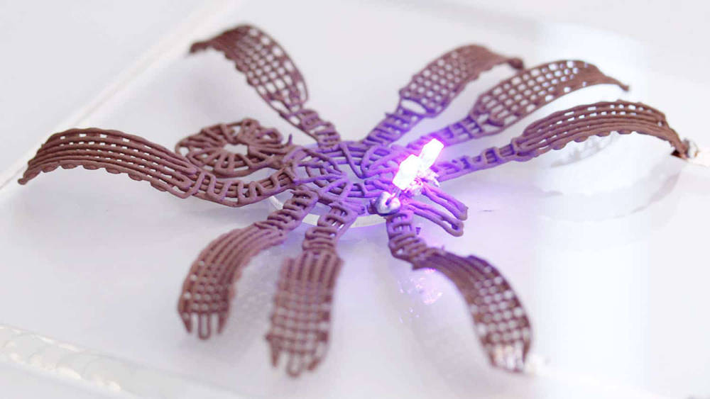

The resulting gel can be printed using a conventional 3D printing nozzle and retains its shape when printed. Courtesy: North Carolina State University
The resulting gel can be printed using a conventional 3D printing nozzle and retains its shape when printed. And, when allowed to dry at room temperature, the resulting 3D object becomes even more solid while retaining its shape.
