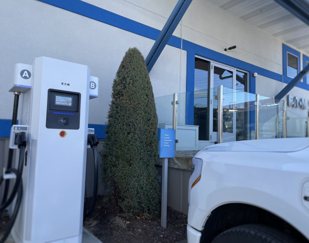

The type of charger required depends on the typical distance driven per day and the size of the battery on fleet vehicles. For example, if fleet vehicles include sedans, pickup trucks and vans that are driven less than 200 miles per day and are plugged in at the end of each day, alternating current chargers should be adequate to provide a full charge overnight.
On the other hand, direct current fast chargers, which can charge most passenger EVs up to 80% within 15 to 45 minutes, are well-suited for around-the-clock or on-the-go operations but require higher electrical capacity due to increased power demand.

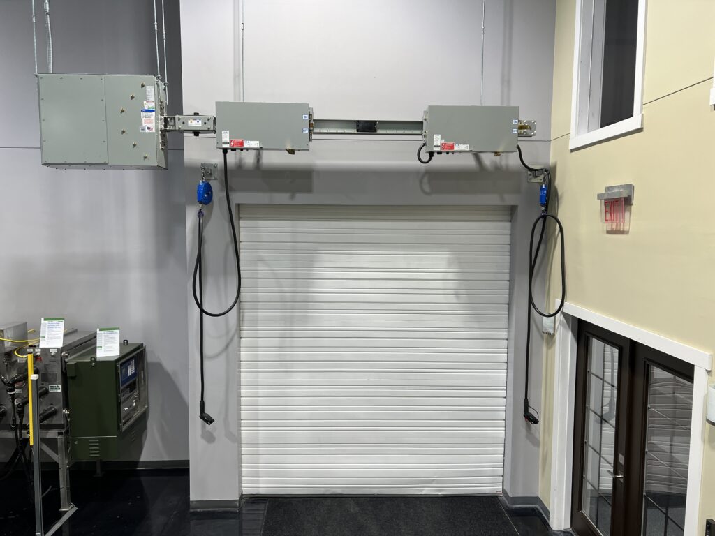

  • Busway, a common electrical distribution solution in industrial environments, can be used to integrate chargers directly into the bus plug, providing a scalable and future-proof footprint.
Figure 1: Direct current fast chargers are well-suited for around-the-clock or on-the-go operations but require higher electrical capacity due to increased power demand. Courtesy: Eaton

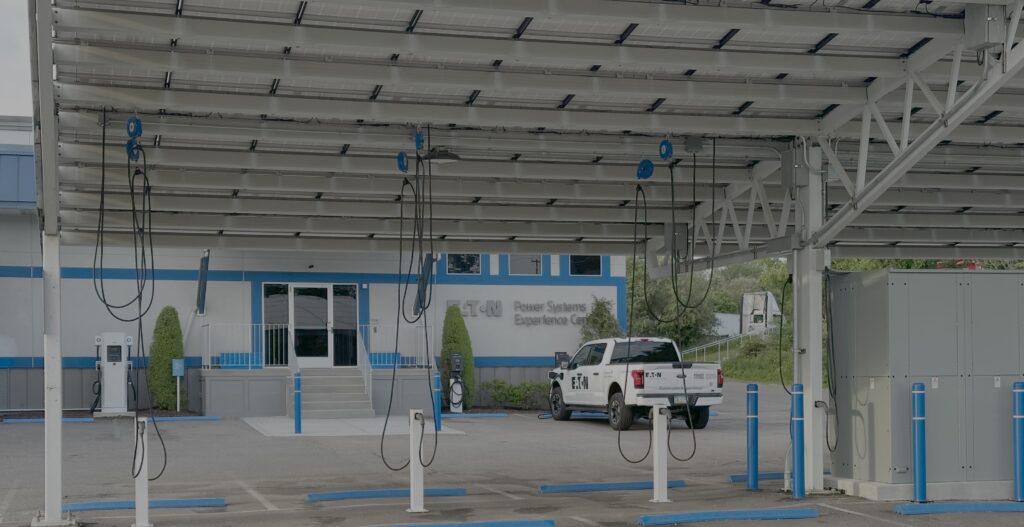

An alternative to utility service upgrades is investing in a microgrid EV charging ecosystem that incorporates an energy storage system and onsite renewable energy sources. This infrastructure investment can improve energy self-sufficiency and accelerate decarbonization goals. Battery energy storage systems make it possible to store off-peak energy from the grid or energy generated from onsite renewables, allowing the facility to switch to stored energy during peak utility rate periods — and even monetize excess energy when possible.

Figure 2: Electric vehicle (EV) charging busway enables the ability to expand and reconfigure infrastructure with no concrete work required. This overhead power distribution technology makes it easier to deploy, scale and manage EV charging. Courtesy: Eaton

Figure 3: Integrating onsite renewable energy sources provides added electrical capacity for electric vehicle charging without utility service upgrades. Eaton Experience Centers in Pittsburgh (pictured) and Houston provide hands-on training environments where visitors can see electric vehicle charging infrastructure and industrial power systems at work. Courtesy: Eaton
