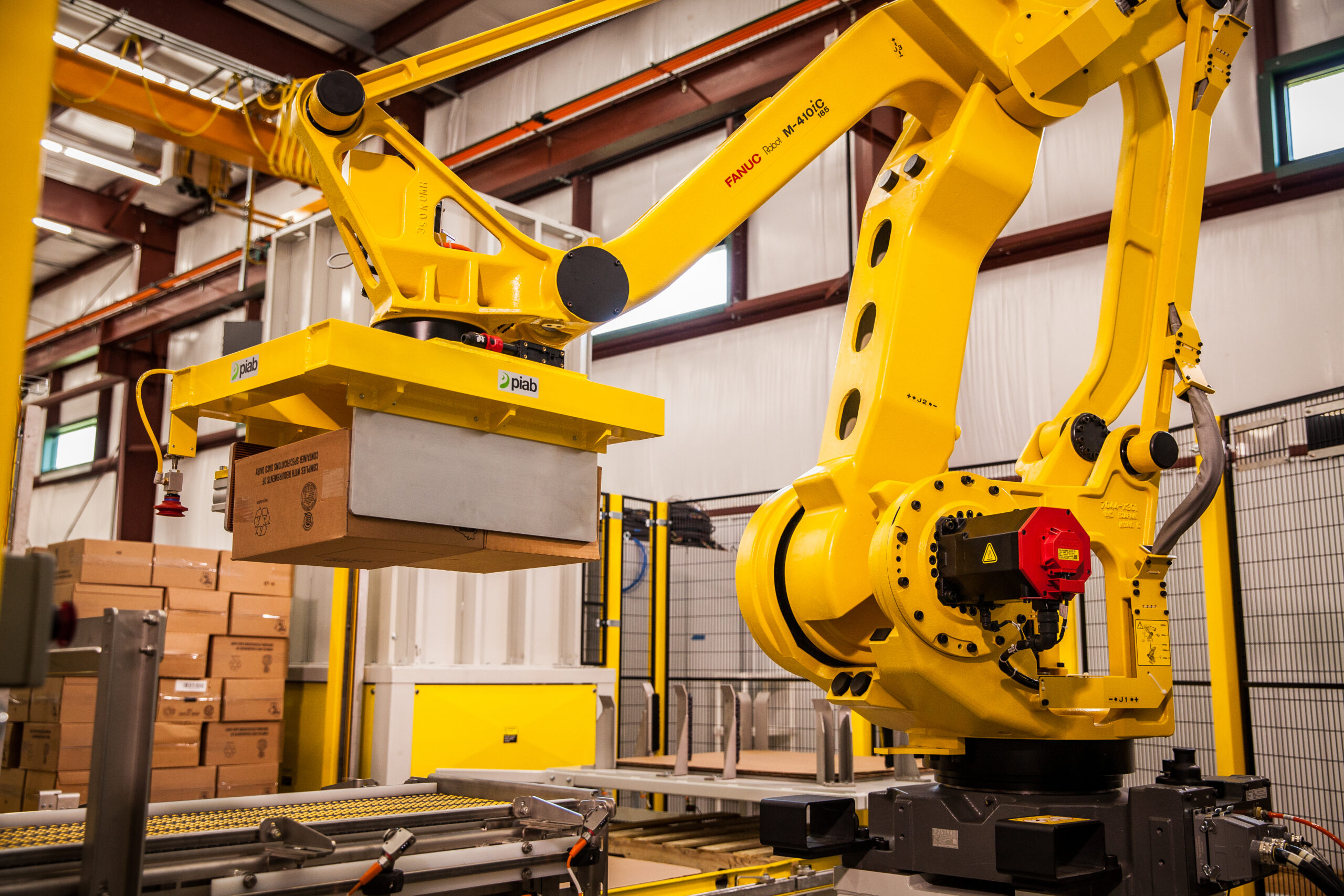

Palletizing (tertiary packaging). Palletizing robots automate the stacking of products onto pallets, preparing them for shipment. These robots can manage a wide range of products and packaging configurations. For example, they can handle a single infeed to one or two pallet build stations, multiple in-feeds to corresponding pallet build stations with a stationary robot or a single infeed to multiple pallet build stations with a robot on a linear track. This automation enhances safety and efficiency in the loading process, significantly reducing the risk of injury associated with manual palletizing.
